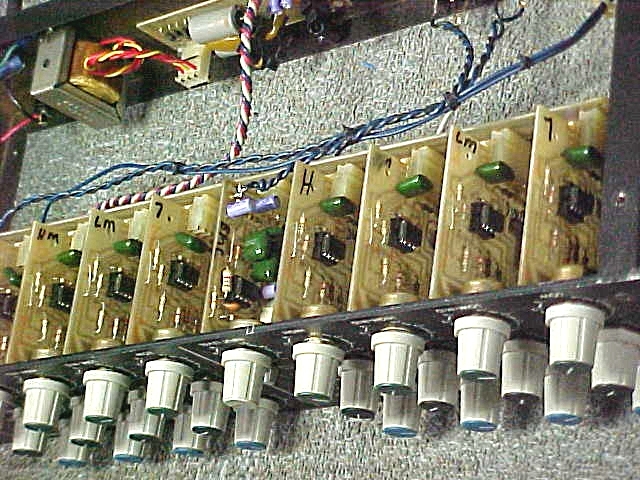

and here is possible to see the inside of the unit:
Symetrix se400 dual parametric equalizer schematic - Music Electronics Forum
I would also like to know, which modification can reduce the floor noise? would it be to change the power supply?

The company revive audio, has the feedback that it can sound much wider by changing the Opamps for higher quality ones, but no data are given on the ones they changed, they also have the opinion that LF353's are of a lower quality... I like the sound is pretty decent, but is not "incredible"... the EQ is a very rare piece and I like it of course, but if I can improve its sound and get a much better quality EQ, why not? I like the idea of the 80s is at some point something "romantic", but it's 2021 ... if it were an API EQ, well, that would be different because surely their Opamps of the 80s, have a super special sound and are definitely not cheap pieces of less than 1 dollar as the LF353.

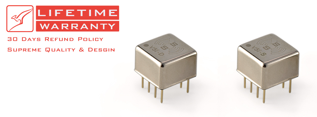

@Mark Tillotson
Thanks for the recommendation,
have you ever had experience with the burson audio V5i? or do you know anyone who has used them in units like EQ?
Supreme Sound Opamp V5i - Burson Audio
Do you think there is really an improvement in audio clarity and transparency?
I leave a picture of the burson and one of the EQ inside just in case you are curious, greetings!
