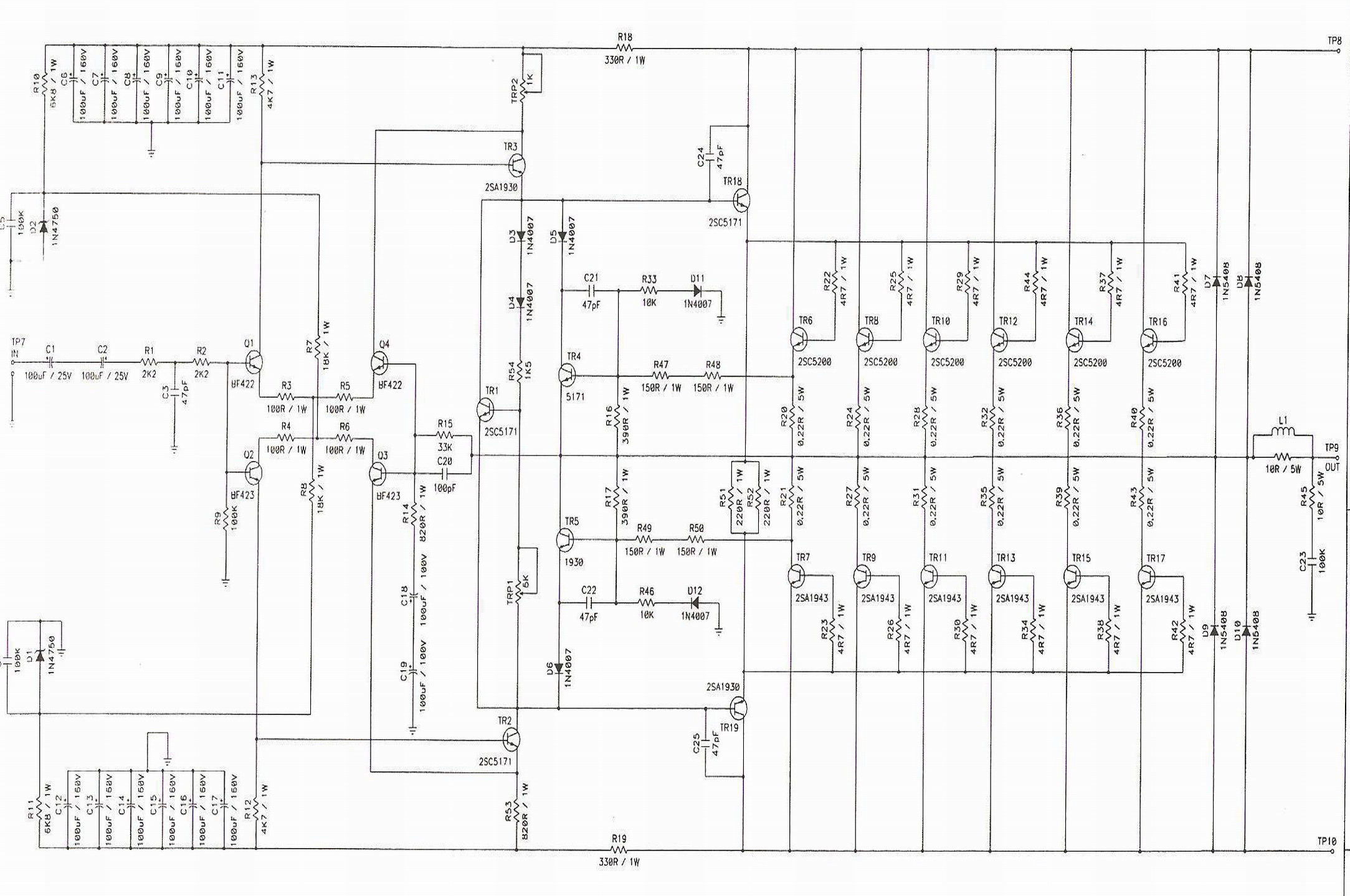

Brazilian epidemic, contagion, plague, pestilence!
This the national standard, to me seems a plague, all
copies of the Leach amps ... some of them, the copies, includes
the same part number, same board layout, same resistances and capacitance
and sometimes same capacitor values..they use more modern transistors
disguise, but actually copied and neither took the
work to make a good copy .... epidemic seems to me .... as
contagion spread throughout the national territory,
all factories dozens of professional models... all them with the same ..
circuit .... I do not like the sound .... seems to me, synthetic , alike the
comparison of natural orange juice with Tang synthetic powder.
But there are those who prefer tang.
I have assemble..the ones i can remember, 5 amps in this same style,
then gave up permanently .... you had some
very good experience with this type of amplifier?
those symetrical ones, double differential ... made comparison with others?
Have you appreciated this one...this topologie, this style?
They are multiplying..alike viruses....3 new factories each month...there are already
hundreds in operation, all them using the same circuit...something you could see
in Marshall Leach pages.
Now a days, the almigthy Selenium (second most important speaker factories in Brazil..next to Bravox) bougth two factories, and now they are also
producing the same kind of circuit.

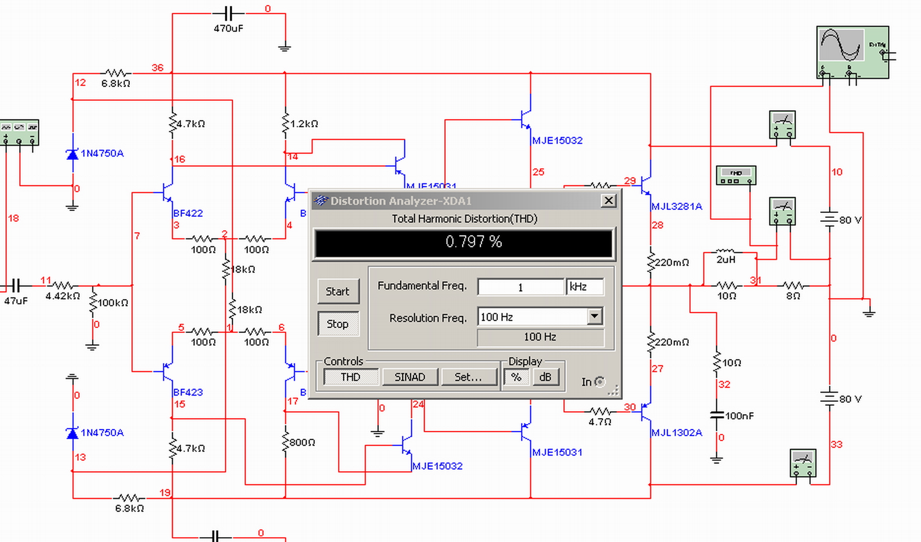

I have simulated...fourier is fine..harmonic distribution not so nice.... THD very high...
even using other transistors and voltage regulation in the rails, series rail resistances
and tweaking values..i could not have decent distortion..now a days..amplifiers are
distorting less than 0.009%
Do you disagree?.... tell us why...have tested....had experienced moments of satisfaction with
these kind of amplifiers?

You can make a very good or very poor Leach amp out of substantially the same components. If you "don't have a clue about electronics" it can be on the poor side.
Carlos - your simulation is flawed. First, the VAS -and therfore the front end -is seriously and intentionally out of balance. Tsk, tsk tsk. Eva's going to put you to bed without any supper. Second, the MJE1503x suck as VAS transistors unless they're buffered (miller capacitance is too large and nonlinear). Heck, use the models for the BD139 if that's all you have. Third, with only one output pair you're suffering from beta droop at high power - even with an 8 ohm load. Put in the rest of them (just use the area scaling factor if your simulator limits the # of transitors). The good professor solved this problem by using a triple. Fix some of this and you'll get better than 0.797%.
in addition to wg_ski's comments, there looks to be a pretty significant error in the schematic. the top mje15031 after the diff amp looks to have it's collector and emitter connections reversed. i would guess this stands out in the sims at least for dc operating point?
mlloyd1
mlloyd1
Thank you folks...all comments readed, and will take a look at the schematic
Yeah...schematic is reversed..but the simulation schematic seems good..at least current is ballanced, also voltage and small off set.... output waveform good enougth.

These kind of amplifiers, when correctly implemented are
way better than doug self s so called blameless.
I published such a design that you eagerly criticised
since it seems that you didn t manage to make a single one
work well enough, so you branded the amp bad rather than
asking yourself some questions about your ability to implement
such a design, prove is that you didn t use a single technical
argument to prove your point.
http://www.diyaudio.com/forums/solid-state/155993-awb50-simple-power-amp.html#post1998594
Contrary to a single differential that will be very tolerant
of mistakes and will still work relatively fine, a symetrical
differential , although very simple , ask for a little more
skills to produce the good resuts..

the complementary LTP input stage is similar to what Leach has used.
But the rest is completely different.
No Cascode
Dual output from both LTPs
Dual output driving a folded Cascode.
Drivers as VAS
No triple EF (Locanthi T).
Global over full frequency instead of LF feedback
No HF feedback loop excluding last stage.
No Cascode
Drivers as VAS

I did build a blameless well before Doug Self highjacked
the idea and used it as his typical design...
I wasn t even an adult at the time.
Anyway, if you need some explanations about the
subtilities of the symetrical siblings, will be a pleasure
to give some explanations..
Andy_c , who is infortunately no longer by there
did some smulations to compare the blameless to
a symetrical differential, and did found that doug
self prefered design was better, prompting many by
there to applause the technical comparison that were
in fact badly flawed in the behalf of the blameless.;
I did recheck the comparisons, and it appears that the
symetrical differential is better even if it use less
negative feedback..
Highjacked?.... really?... Doctor Self did that?
heheheh.... maybe you are kidding.
Slone made a Blameless..do not know if he made in advance compared Doctor Self..or the opposite... in the reality...in our modern world, it is very difficult to find the ones have really created something new...maybe Dunlap....but even his design, others may say was not him.
Well..it is not impossible two persons, different places and same time to have the same idea.... things are intuitive and some evolution are obvious.... alike some consequence...if installed CCS to the differential..then why not to the VAS, to the Drivers and so on?.
First stage differential....why not the second stage too?...so... consequences, obvious developments..when one is publishing the differential, other was creating the differential VAS.
But for sure you are skilled..... a good engineer Wahab...there are the Practice Skill...the theoricall Skill and the ones have both.... there are the one have scientific approach and the Imaginators.. as "they think".... they have a lot of opinions..some of them have never touched a soldering iro..have never compared anything....but they think a lot.
You are good.... fast you have found that 220 would be the best value to the my amplifier, the first Vas emitter load.... you realise very fast...because good theorical or practice skills, or even both of them.
It is interesting to know what people "think" about that...but also, would be more interesting to know and to listen, the ones made the complete job... the ones have analised the schematic, the ones have calculated, have simulated, have assembled, have listened and have compared the way i did..... this way..i will know thougths from another one that had the same kind of experiences compared the ones i had.
I remember 5 amplifiers, in the reality five variations around the same schematic..as Marshall Leach has two main models and these ones i am talking about are sligtly different.... my people have supressed something...reduced, simplified a little...in the reality...i have not registration of all i have made..but for sure more than 60 amplifiers with double symetrical input i have assembled, and listened, and compared.
Much more than 5000 units made.... now a days i am super lazy, doing 3 or 4 a week (200 per year or less)...but was not so slow this way...around 1.7 each day was the average.... then calculate what this means in 50 years.... i am thinking in 5000 thousand..but calculating you see that can be much more than that....6 times more.
And always i found this one not good....always i found the boostrap ones much better..also the ones with chips not very good, and the ones with EF sounding better.
Well.... people alike you Wahab, that is a little bit old and have build hundreds and thousands can say something...so...i respect that you say it can be even best than Blameless... sadly, my years of research cannot confirm what you said...so..there's something strange on that.
