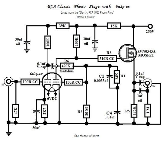

Along the lines you're thinking, use an ECC99 as in the LTP. Don't forget the CCS in the splitter's tail. IMO, it's much easier to use a quality enhancement mode MOSFET as the DC coupled buffer. The ECC99 triode is quite "muscular" and will have no difficulty in feeding an IRFBC20. An ID of 15 mA. will get the O/P impedance under 100 Ω.

DC coupled MOSFET

Well, to use a MOSFET as DC out buffer as you proposed looks very smart for me. Please be so kind and describe it a lite bit more detailed how to wire it. The ECC99 is a great tip! Thanks a lot for that!

Karsten,
Lesen Sie MOSFET Follies! Then, look at the phono preamp schematic I've uploaded. That design shows a small MOSFET DC coupled to a 12AX7/ECC83 section. You do the same thing with the big FET. Don't forget the gate stopper.
IMO, the 12AU7/ECC81 is a poor voltage amplifier, due to non-linearity. I would not use it in a LTP. OTOH, it's OK as a cathode follower.
