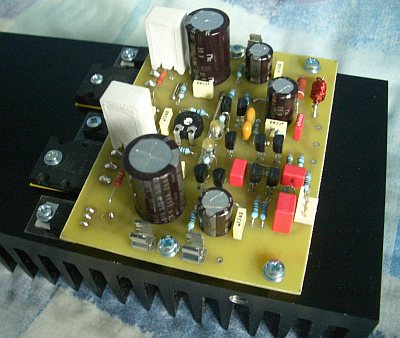

One amp is just about ready for testing. I ideally need to get the allen type mounting bolts and change those 1.2ohm resistors for correctly rated ones (they are 1W but should be 2W, will do for testing). I'm off out soon so will get back to you tomorrow, hopefully it works! The overall mounting scheme is much tidier and simpler than my previous build 🙂
Looks like a nice clean build! I noticed you didn't use the recommended wimas for by-passing.
One more advice, use extra capacity for the power supply capacitors as the increased power in class A will drain them much faster.
For example, my 2x33.000uF per monoblock only last for 3-4 seconds after I switch of supply power, vs. 10-15 seconds with the recommended bias setting (55mA).

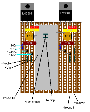

I plan a regulated supply, the design is here:
http://www.diyaudio.com/forums/showthread.php?s=&threadid=56106&highlight=
This should eliminate noise problems you can get with class A. Will I still need extra capacitance before the regulators though say? Bear in mind there are no big bass peaks to handle!

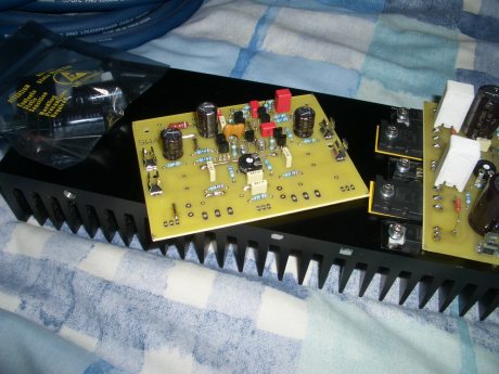

Dr.EM said:One amp is just about ready for testing.
I believe you will get better efficiency from the heatsink if you mount it with the fins running vertical and the transistors mounted at the bottom of the heatsink. (turn the board 90deg)
André
The heatsink will be mounted so that its fins are vertical when finished, this was just easy to photograph. The heatsink forms the sides of the case and the fins are all on the outside.
If you mean rotate the board on the sink then it wouldn't fit. It literally just fits the way it is (100mm sink, 100mm board, needed some sanding of the board to allow the case top and bottom to be fastened).
Hopefully it will be enough this way anyhow, the traditionally biased Symasym makes a barely noticeable change to heatsink temperature even after hours are normal volume.
I have nearly finished the second board incidently. The first seems to work but I haven't set up a proper test yet. Got to build these regulators but need some plain clad board to do it.
I found my allen bolts so put them in. Much firmer than crosshead etc. Yes, I will be applying thermal compound to the micas but I know I will have to take that board off (to change resistors and solder leadouts) so will do it in the final assembly only.

I will likely be doing this regulator on striboard, due to lack of other resources. It shouldn't be an issue, I will have a ground fill (ie, large low resistance area), and the input and outputs should be handled by stripboard tracks. I checked stability with a breadboard model and its fine; though interestingly 100nf ceramic discs didn't seem to work in place of 47nf polys? It oscillated with them, I thought they were better for decoupling, they have seen better days though 🙂
