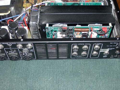

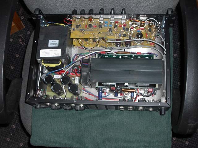

My SM-900 has 2 amp boards/heatsinks in a tunnel inside, still same arraingment sort of.
I have some photos of the rebuild.

Hey! Thanks, zero cool. I really appreciate the pictures. I think the "wind tunnel" arrangement is interesting. They sure made some significant changes from the old 400 that I have. I have a hunch that the old TO-3 products weren't the most reliable. There is not even a fan! If you're really curious, I can post some photos of the sink arrangement on my 400.
Yeah i would love to see the inside of a 400.
Now rememeber this is just the way the SM-900 works because of the dual amplifiers inside for biamping or stereo operation.
The 2004, 4004, WM-300 and just about every other model just uses 1 heatsink mounted to the rear with no fan or anything. same circuit as this but only one sink etc.

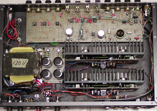

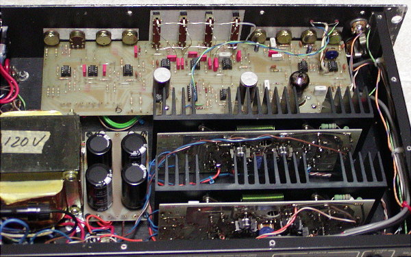

Yeah you would have to do massive changes to use the MT-200 devices.
What you could do, is buy the ST-800 power amp. which is essentially a SM-900 amp section only. these sell for $300 or less and remove the amp modules and swap them into your amp. but, then again. why go through all that hassle. fix your 400, sell it and then buy one of the newer amps that already have the MT-200's in there.
I see from the photo's that the regulator issue i have with my newer amp is a carry over from the older models. your amp has the same circuit basics going on there. only mine they stacked two 5 watt resistors on top of each other piggy back style with out any additional support.
