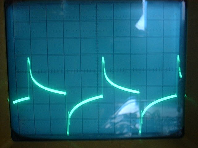

Does the primary waveform collapse (viewed on an oscilloscope) when you drive it hard?

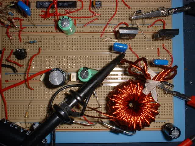

The two usual problems are layout and leakage inductance. Could you post pictures of your transformer and prototype?
No problem. I'm at work at the mo but as soon as i get home i'll take some piccys so you can get a better look. The proto is still on breadboard but it's fed by a high current battery connection direct to the transformer and fet sources.
What is 'full load'? If it simply means full duty cycle, post photos of the primary with the 47 ohm load on the secondary.

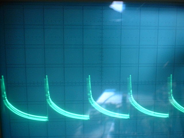

And last but not least no load at all. The controller is now just idleing and somtimes there is no drive at all........
Hope this gives a clue as to why i cant draw more than 100W out of the coil before the voltage drops off????
P.S my scopes trigger was not set very well hence the mirrored pulses. With carefull adjustment the pulses are one high then one low in sequence. I didnt have time as the FET's dont have heatsinks on them and i was juggling with the camera and load connections LOL

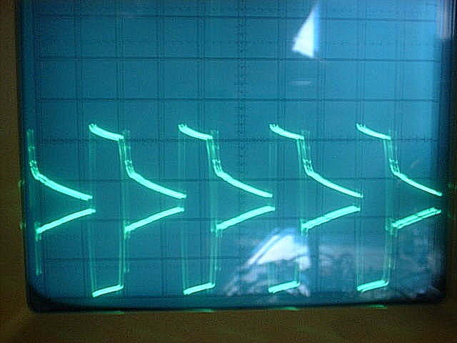

Full Load is when i'm drawing around 100W out of the secondry and the duty runs up to 100% in an attempt to try and supply more power to regulate the output voltage. This was with a 4R load trying to regulate to 50V but on connection of the load the output fell to 22V.
The Half load waveform is with a 47R resistor regulating to 24V on the output.

It doesn't appear that you're getting any coupling the between primary/secondary windings. With a 4 ohm load on a 1:5 ratio transformer, the voltage on the primary should have been pulled down more, especially with the high Rdson of those FETs.

That core isn't suitable for use as a power transformer.
Try to salvage one that's being used for the power transformer in a car amplifier.
Go to 4+4 on the primary windings.
Insert a fuse (~20 amps) in the B+ line feeding the power supply. When you get the transformer working properly, it's going to try to draw a lot of current (50-70 amps) when you load it with 4 ohms. Your supply and battery may not be up to the task). You won't be able to drive a 4 ohm load with only those two FETs. You'll need at least 4+4 FETs rated at 50 amps or more and they'll have to be on a heatsink. For the final supply, you'll need something like the 6+6 IRF3205s.

Also, the picture does not show clearly the way in which you wound the transformer, some more information on that would be appreciated. Essentially you should wind the primaries first and pair them as previously mentioned (bifilar, maybe split in smaller sections), then wind the secondaries paired too. Never twist the pairs, just bring them parallel and close. The primaries should be close to the core (for minimum leakage) and secondaries should be close to the primaries too (for best pri-sec coupling), so twisting the wires of each winding in big strands is not a good idea.
Note that you don't really need a big toroid, this is because they require less turns becoming harder to wind and resulting in worse coupling. I prefer small toroids in the 30mm OD range and to use two or more if one is not enough to fit powerful enough windings. Power output capability is not related directly to core size, it's only related to the parasitic inductance and resistance of the windings.
