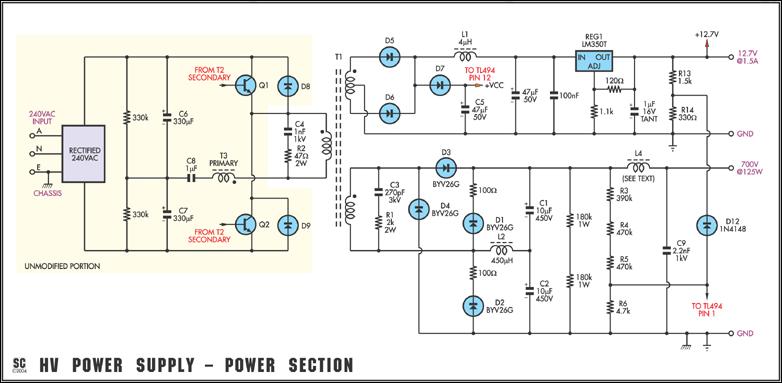

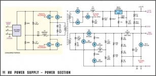

Here's an article that describes exactly what you want -
"Regulated High-Voltage Supply For Valve Amplifiers
How to modify a surplus PC power supply to produce a 700V or 400V high-voltage rail"
You'll find it at:
http://www.siliconchip.com.au/cms/A_102096/article.html
Although it will cost $5 - still think of all the money saved on PTs.
I just downloaded it myself & am reading through.
Extract from article "The circuit is capable of excellent performance. It maintains full regulation at up to 125W, with ripple at 2V peak-to-peak, or 0.3% at full power. This is quite acceptable, as most of the ripple is at twice the switching frequency (60kHz) and so is inaudible.
The 100Hz hum component is only 0.08%, which shows the excellent regulation of the TL494, since the rectified mains source contains 13% of 100Hz ripple at full power. Over-current protection is retained, with a LED added to indicate when it is active. "
I believe it is safe - Would be interested in discussing it here. Here's the final schematic.
