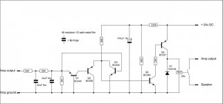

Geminni, can you provide schematic used by you? And the component values too if not visible?
The plop, bang or click comes instantly after the power switch is released.
This is the schematics
http://www3.telus.net/chemelec/Projects/M250/M250-DC_Protection-SCH.png

Your DC offset protection circuit doesn't appear as though it will drop out instantly. The time constant of the 12volt supply to the relay plays a big part. Slow drop out is a major failing of many circuits.

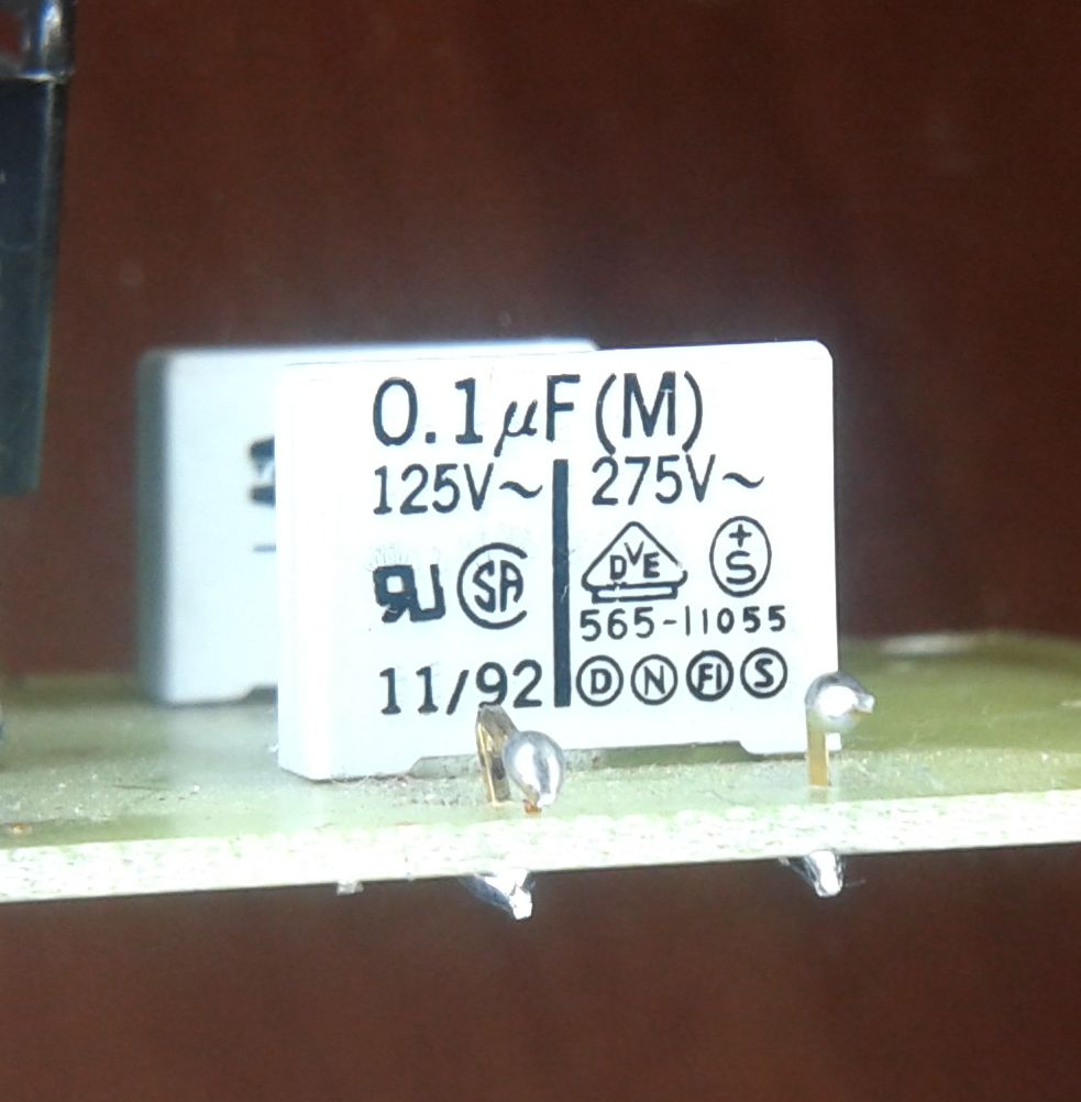

Its a very good point. Even if you have an ordinary cap that says its good for 1000vdc/400vac DONT use it. They must be rated as CBS240 advises.
I didn't know about that x-rated caps. Is there a print on cap just like that "x" or something?
I have found some caps and here is the picture so you can tell me if I can use something like that.
That's an old cap (11/92). I wouldn't like to say 100% as todays requirements are strict.

I didn't knew that was a date 🙂 Thank's for that!
Can i use that one from my picture just for test? I'll by the new one if that 0,1uf stops switching noise.
It should work. You'll also find suitably rated capacitors in dead PC power supplies. A 1Meg resistor across the terminals is also recommended to discharge the cap
An X-rated cap will say so; it may say X1 or X2. No X, means 'not X'. You can use a Y-rated cap instead, as these are even more reliable. Y caps tend to be smaller in value and may be more expensive.
Its OK to try as a test.

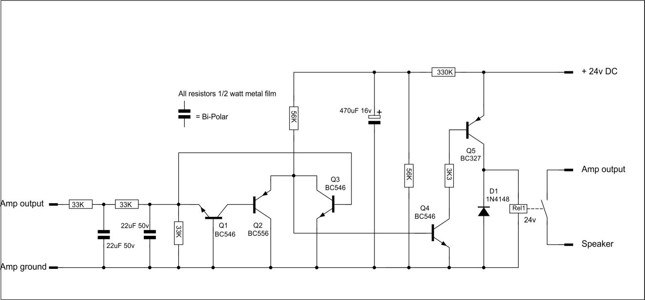

Well, this is embarrassing. I have made a mistake about schematics. The speaker Dc protection in this amplifier is this schematics, it is from a project N-Mos amplifier.
The previous posted protection is from M-250 amplifier and it is working in my Quad405 box. Today I have tested both amplifiers and the conclusion is that the one in Quad405 is working without clicks and the one with N-mos schematics makes that noise. The Relays are the same type in all amplifiers. Difference is schematics for DC protection and the thing that in troubled amplifier I have also soft start for toroid transformer. Can that make that clicks noise when switching off?
Just to add that Dc protection has its own transformer in both amplifiers, it is not connected to main transformer.
