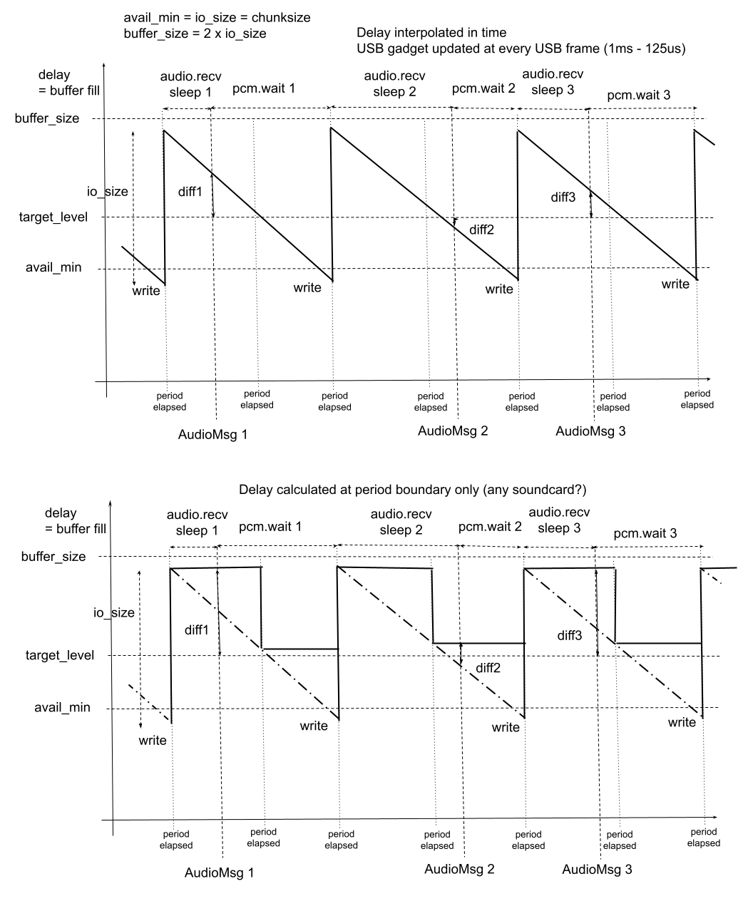

I was thinking about reliable implementation which added only minimum latency at start.
My testing modification was just a quick hack how to pass zeros to the playback device.
This is the playback buffer fill when running:
IMO the zeros should be injected on the playback side (to avoid startup delay in Processing).
The playback device needs to start consuming the incoming chunk from Capture with minimum delay to minimize the bridge latency. That means the playback device should have as few zero samples in its buffer as possible when the first captured chunk comes. Alsa offers rewinding, but some devices do not support it (a great paper on alsa rewinding is http://lac.linuxaudio.org/2015/papers/10.pdf ).
IMO the zero blocks should be only 1 period long (chunk is 2 periods) and sent more often (until the first chunk arrives). Maybe avail_min could be lowered to 1 period for the time of kickstarting, making the buffer fill fluctuate around 1 period. Using avail_min less than one period may be dangerous for devices which calculate the delay only at period boundary (i.e. delay information with only large granularity, the second chart) - it could result in buffer underflows.
Also playback xrun handling would need to be analyzed. Since xruns stop playback, that would also pause capture. Threshold is set at 1 sample, so any already captured chunk in the chain would kickstart the playback upon its restarting (dev.prepare). However if there was no chunk in the chain yet (like xrun occuring before capture had time to produce the first chunk), playback would again need the zeros kickstart. Maybe the zero kickstarting could handle both the initial startup and xrun recovery - no incoming chunk -> keep sending 1 period of zeros (with dev.wait), until the chunk arrives. IMO for xruns in most cases no zeros would be sent as in most cases the chain would already contain some chunk ready pro playback.
As of my test requiring 2 zero chunks to start up - I thought it was caused by threshold being set at 1 chunksize. But since it's at 1 sample only, IMO the first chunk reached playback, it was played, but this one loopback timer tick was not enough for the capture to finish generating its first chunk for the playback to continue running. Generating the kickstart zeros in the playback loop should avoid that.
Edit: Maybe the zeros block could be smaller than 1 period (like half), with the kickstarting loop running faster, to minimize the added delay.

The Wasapi and Coreaudio backends pump zeros to the playback device if there is no available data. They both use a separate thread for handling the low-level shuffling of data. The Alsa backend is different in that it runs a single thread only. Maybe it's time to start looking into adding another thread also there. It gives some advantages, and it would solve the kick-start right away. The downside is all the added complexity.

Yes, but you need the "kickstart" the playback to get the capture loopback clock running. I am not sure CDSP v. 3 does that, IMO not. For now (and maybe for always) you are better off with just enabling rate-adjust and letting the loopback clock be controlled by CDSP.
I guess this is probably part of a bigger conversation on what @HenrikEnquist has on the roadmap for CDSP.
I will most likely implement the separate thread in the alsa backend at some point, but it's not a very high priority for now since the current solution works well for the majority of use cases.
But even with that change, I would still recommend using rate adjust in cdsp instead of changing the timer source of the loopback. I don't see much benefit from using the timer source method, and it makes the loopback pretty quirky to use.
