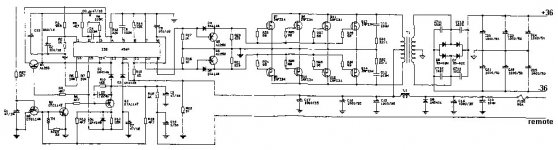

soundNERD:
There's some problem with the schematic: push-pull topology in SMPS is vulnerable of transformer core saturation .
The MOSFET and the switching transformer has very low resistance, so a slight unsymmetry on duty cycle or on resistance could cause large DC current passing through the transformer and saturate it. Then high current will flow and.....
It's a classical problem in SMPS papers, and somebody even used DSP (!) to control the bridge to overcome it.
Perhaps using other topology like half bridge (with a big capacitor series with the transformer primary ) or use some current-mode PWM controller to control the bridge and ensure the current symmetry will be safer.
Another simple choice is : use a charge pump made by capacitors, diods and a half bridge switch(something that's used in class D) to boost the voltage up. We used it on our robot to get 24V from 12V and it's reliable. 🙂
Use more capacitors and diods can get a higher voltage,but the output voltage is fixed to several times of the input voltage and can't be adjusted continuously.

that schematic is a commercial power amp, its been used since many years in many car amps and i never saw one of those with problems you related. This almost same exact schematic is used also in the higher series of Alpine car audio amp, they were still using the upc494 int the mid 90's. Its an OLD schematic, shown just as a guide.

Hey i brought an alpine amp that has a pwm powersuply in it similar to this one
i brought it pretty cheap and found it was broken and never took it back cause it was that cheap i opened it up and the powerfets had been major cooked
they are irfz44 about a 50amp fet that switches ground just like in the diagram
with the transformer what kind of load should it put on the fets
cause mine is putting mega load on the fets and practically a short on the fets
sorry to rabble on a bit
what kind of resistance should be on the 12v side of the transformer
sorry for my stupid question.. im only 16
thanks

Not a stupid question, congratulations if you are only 16 and are involved in these things, then the only thing I can say is: well done, keep working on it!
You wont be able to measure the load that the transformer puts on the fets, as with a multimeter you only see DC, and the primary of the transformer is almost a shortcircuit from the fets to +12V.
The load the transformer puts in the fets effectively at the working frequency depends on the load of the power supply, that is, the current the amp is demanding. To put it simple, if the amp is demanding 1A rms, the primary current will be that multiplied by the turns ratio of the transformer (for example, about 3 if the supply is +/-36V).
If your mosfets have exploded there are some simple possibilities:
a) There is a shortcircuit in the secondary: try to disconnec the amplifier from the power supply (if there are coils you can simply desolder both of them), and see if there is shortcircuit. Sometimes the capacitors fail to shortcircuit, what cause huge primary currents and even fet destruction.
b) There is a problem in the driving of the mosfets, that cause its spurious destruction, although not likely in a commercial product.
c) A problem in the input supply (like someone has connected polarity backwards or 220V or whatever).
Hope this helps diagnose your problem.

I'm right there with you man, only 16, got me some good sounds subs, but just blew my amp and am out of money for a new one that can push 500x1 at 1 ohm, so looking to build one myself...
I have been all over, reading everything I can get my hands on. I have really been interested in the smps project at esp and have all of the major parts to build one from my blown amp...
just a few questions, toroid or e-core, i have a very large toriod, at least 2 in. in diamter, but i also have an EDT49 core.
also looking at the mosfets, going with 4 irf540 per rail
got good capacitors out the wazoo cause my blown amp was filled with low esr 105 degree rated capacitor for the supply
ready to build, but i should i make the pwm circuit on a seperate vero board and transfer the signal to the mosfets by wire, or have the mosfets on the board too, keep in mind that this supply will be pulling about 30A at 12V per rail...

For the core, make sure it is ferrite (not iron powder or similar).
About making the modulator in a separate board, keep in mind that the gate connections should be as short as possible. If that's completely impossible, use a pair of twisted wires to gate and source of the mosfets to minimize inductance of the loop, that could cause ringing and undesired turn-on of any mosfet just when it can do more harm.

By the way, IRF540 is a very good choice. Easy to get and very robust. If you can, use IRF540N variation, it is even better and have lower Rds(on), that is important:
IRF540: Rds(on)=77mohm. For 30A, if your use 4 per primary side, you have 77/4=19.25mohm. At 30A, P dissipated due to resistive losses = I^2*R=17W aprox.
IRF540N: Rds(on)=44mohm. P dissipated is now 9.9W in the same conditions.
BTW: Try to use International Rectifier mosfets, they are rated for avalanche, etc. Are much more reliable than other brands (and I don't have relationship with them 🙂)

If it's real 500W RMS amp then current consumed from battery can be much higher, over 50A. IRF540 is 100V device and not quite suitable to operate from 12V battery, the usual and cheap FET choice for 12V car amp SMPS is IRFZ44N ->55V, Rds(on)=16mohm - about 3 times lower losses. Slightly better and more expensive are IRFZ46/48N. Even better are IRF1010 or IRF3205 (the last you will need only 2 pairs).
Toroid core is preferrable to ETD at input voltages as low as car battery. It's been mentioned a lot about it here.
Your 2-inch toroid core is sufficient for such SMPS. Use 25-30kHz switching and 4 turns each half primary winding for good efficiency.

Alme is right, although IRF540(N) has the advantage of being readily available and cheap.
However, if you need the ultimate in efficiency, use for example the ones indicated in my article in ESP: Onsemi's NTP75N06, they feature Rds(on)=9 mohms, so with 1 or 2 of them per phase you can be ok. Besides, they worked very reliably for me.
About the toroid, if it is ferrite (that's very important), the size is ok in principle.
ETD39 is also suitable and easy to wind.
About frequency, the lower you go, the less switching losses you will have in the mosfets (they can be nearly as important as Rds(on) losses). Although the size of the transformer required will be bigger too. But I agree in that 30-60KHz is a good start.
