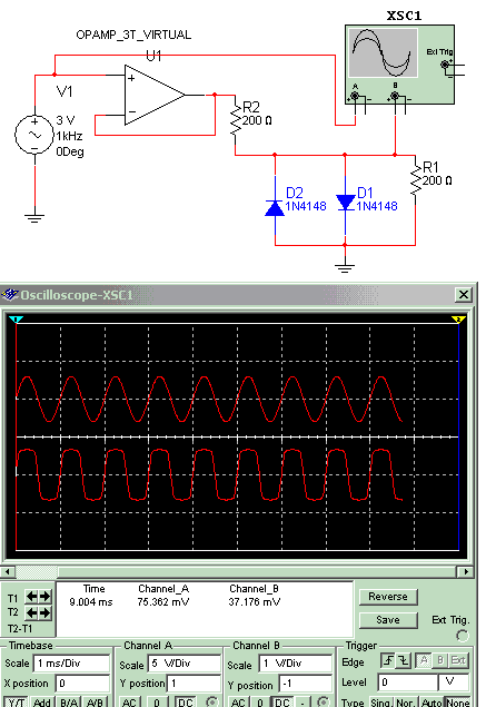

EVA -- yes you quickly burn watts --
here's an idea for slew control using a sine wave and some clamp diodes -- the opamp must be rather capable to do this and you burn energy in the linear region for the switching devices -- but dv/dt is much lower -- it is akin to what happens in some of the Linear TEch controllers:
