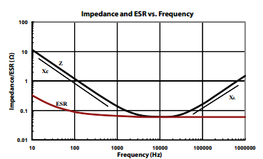

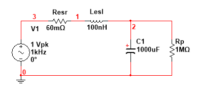

No you don't, as the extra banks will define the impedance with the ESR,
Nope, electrolytics have ESL as well as ESR. Here's the standard capacitor model, and impedance vs frequency from a paper by Cornell Dublier:
