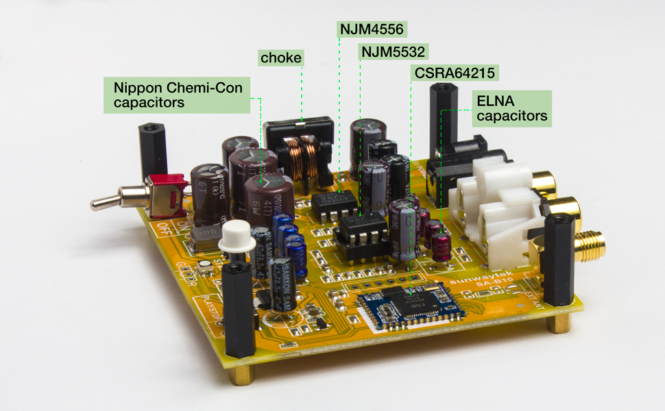

I need some advise, as was planning to replace some Op amps in a blue tooth receiver.
Please advise on the op amps I can swap for, for best sonics. I would not like to go overboard (price-wise) with Burson etc., however if there is anything reasonable, I surely would appreciate.
These are the ones currently installed:
NJM5532 operational amplifier for RCA (DIP8 dual operational amplifiers)
NJM4556A for 3.5mm auxiliary to headphone
What could the above stated be replaced with ? Will discrete opamps make a huge difference ?
Thanks once again.
d.
Attached is a picture:

You can use LM6172 for headfone amp. And, for example, LM4562 for line output.
But, it seems to me (I may be wrong), the main sound quality problem isn't in those opamps.

Thanks for the advise and help. I was leaning towards the LM4562 for the line output, however, couldn't find a dip8 version. I believe I can use the SOIC version with a dip8 adapter.
I presume it will work though, as I don't understand whether the voltage and other specs are interchangeable between the two.
I have rudimentary knowledge of electronics as you may have noticed.

Beware that many of the "discrete opamps" require external compensation if used at gains higher than unity. Check the open loop gain (AVOL) curve to make sure. If it has a -40 dB/decade slope you'll need compensation.

LME49720 is same as Lm4562, basically the part number was changed when TI aquired National Semi.

Actually, the part number was changed before the TI acquisition. National went from two letters (LM) to three around 2007ish. LME = audio. LMP = precision. LMV = general purpose opamps. Etc. The LM4562 just happened to be developed around the time of the change. That's all.
You are correct, though. The LM4562 and LME49720 are the same part. Same die. Different number on the package. That hasn't stopped people from arguing the opposite, however. 🙂

...require external compensation if used at gains higher than unity....
Usually it is low gain that needs a bigger dose of compensation?
Of course reading the datasheet is always a good idea.
That's a good rule of thumb. The issue with rules of thumb is that they're sometimes wrong. This is one of those cases.
The "discrete opamps" I've looked at have had -40 dB/dec AVOL slope with a pole-zero pair centred around the unity-gain frequency (UGBW). This causes the AVOL slope to change from -40 dB/dec to -20 dB/dec around UGBW, and back to -40 dB/dec beyond UGBW, which allows the opamp to be used as a buffer with 45-60 º phase margin (on a good day).
Without external compensation, these opamps will suffer from degraded phase margin once you configure them for a gain beyond unity. Around 6-12 dB of gain, I would expect significant ringing, and at 20 dB gain, they're guaranteed to be unstable without external compensation. Thus, I have grave concerns with using "discrete opamps" in gain stages, including RIAA stages, unless proper compensation is added.

Swapping the op amp will make a difference. However, any lack in those you've already got installed can be attributed to support and/or power circuit....NJM5532...NJM4556A...
So, any benefit of op-amp swapping in this case comes from putting in a chip that has requirements which are a closer match to the support and power circuits.
That is unorthodox and possible and backwards.
The orthodox fix is to repair the support and power circuits to closer match the needs of your chips.
Op-amp swapping, which looks easy, is actually the hard way.

I very very much doubt you will hear any difference.
Besides expectation bias, of course.
If anything, get a better Bluetooth receiver, as a whole element; you don´t have the current schematic, you don´t know what those Op Amps actually do, you don´t have a specific problem to correct and even if you had, nothing points to OP Amps as culprits.
Non designers often believe (wrongly, VERY wrongly) that a "better design" means the same old tired one but with "better parts".
