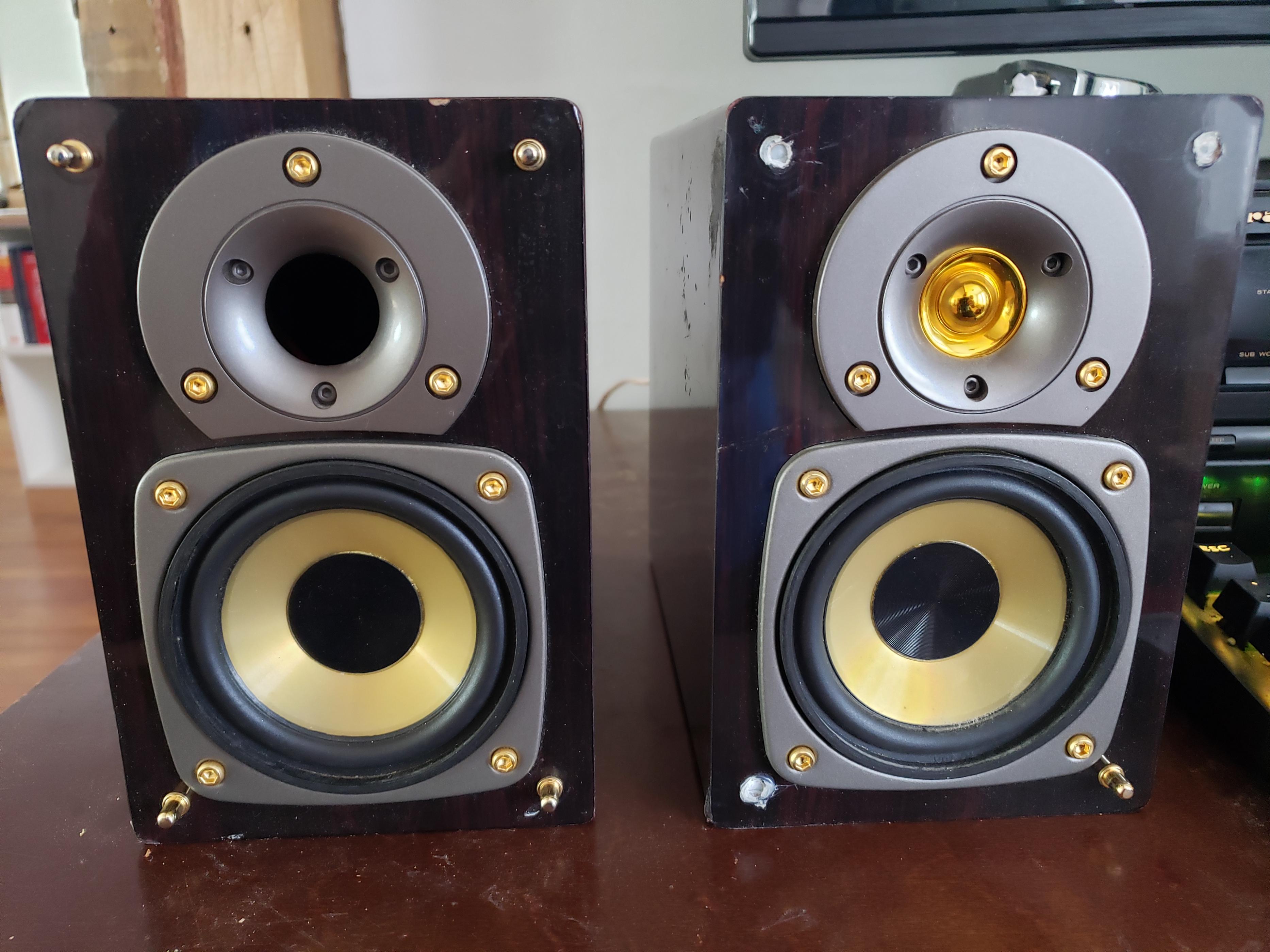

I picked up a pair of these teac ls-h130 to mess around with.

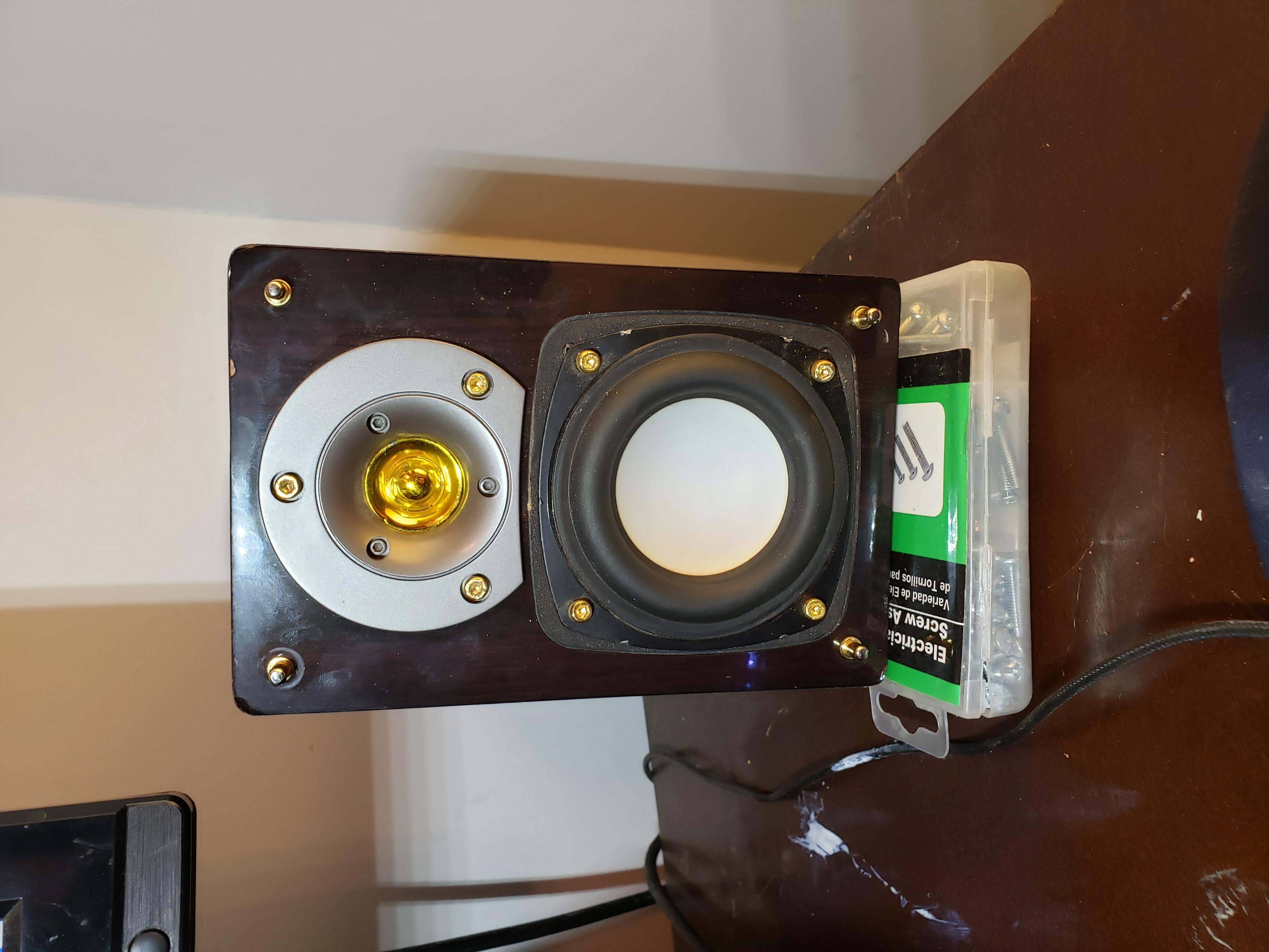

I swapped out the stock 6 ohm driver with an aura NS3-193-8A.
What happened to my crossover points?
Can't say anything for sure without knowing more about the old driver and new one, beyond stating that it probably shifted a bit.
well lets say the old driver crossed over at 3k. (being 6ohms) ....would that effect LP cut in ?
What you will probably end up with is something with a notch in the frequency around 2000-3000 Hz. Crossovers are designed for a specific set if drivers, and changing the drivers means you really ought to fully redesign the crossover if you want the new drivers to perform optimally. Also, since drivers do not actually have constant impedance, even describing them as 6 or 8 ohm is more just a broad generalization, and to properly design a crossover for them, you would need to measure their impedance in their cabinet across the audible frequency range.

Changing *impedance* a bit is nothing compared to replacing a *speaker* with another most certainly having different parameters.

P.S. Without details of the crossover network it is impossible to answer your question.
For all we know, the woofer is being driven 'full range', without so much as a series inductor.
