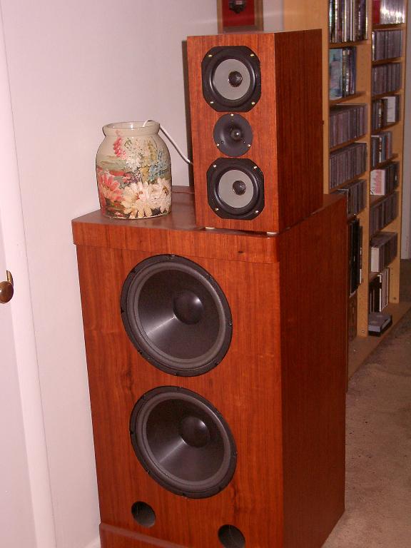

Here is a brief summary of the Swan IV Speaker Builder article just to make sure we are talking the same project.
The Swan IV was designed by Joe D'Appolito and published in Speaker Builder 4/88, 5/88 issues. It is a 4 box system consisting of two 100 Liter woofer boxes each containing dual 12 in woofers and two mtm satellites each containing dual 5.25 dvc mids and a tweeter. The system is bi-amped at 200 hz between woofers and satellites. The satellites have a passive 2000 hz crossover between the dvc mids and tweeters. The article recommends 4 amplifer channels of 200 watts each.
The Pedal Coupler is the 200 hz bi-amp crossover with bass boost. There were no further articles on the project, just some discussion in reply letters and responces published is subsequent issues the following year.
Its my understanding the Pedal Coupler as published will work ok but a more conventional L/R crossover was preferred by most builders. If you want to research sutable crossovers I recommend reviewing the threads for; mox active crossover, and active filter board gb. I have spare empty boards from both threads that I can send you if you wish to complete this project.
I tried attaching a picture of mine which I plan to get out of storage and refurb when I have time, I hope it comes through.....Dave

BTW, wow, what a beautiful job you did on the Swans you built.

I built my pair probably in the late 90's. The mids and tweets were either off the market or superceded by newer models. The tweeter I used was a Morel clone of the D28 and the mids were a slightly newer version of the 5n412db. The tweets should last almost forever, the mids should last almost as long if you treat the rubber surrounds with silicone grease every few years. The Swan 305 woofers were discontinued by Madisound a few years ago but I am sure there are many sutable replacements if your foam is bad (it fails at the edges of the round area) or you could have new surrounds installed if needed. I picked up some surplus dvc woofers from Parts Express a year or so ago as replacements. Poly cone, rubber surrounds, similar t/s paramaters, they should work fine. My woofer cabinets are the larger 140 liter boxes, not the 100 liter boxes the article settled on, the larger boxes require less bass boost and amp power. If I can be of any more help just let me know.... Dave
