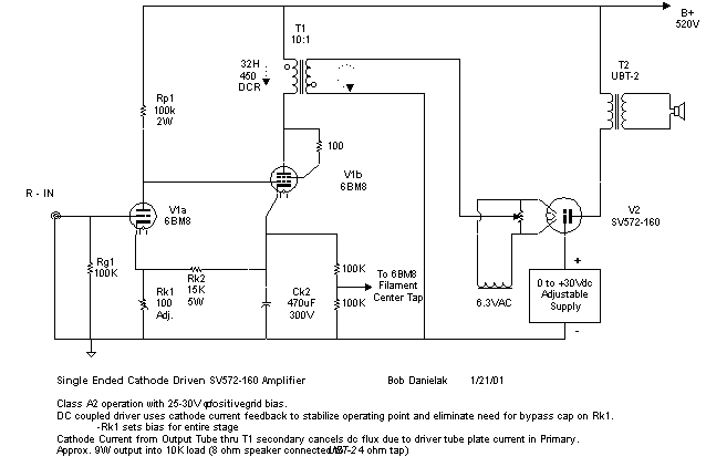

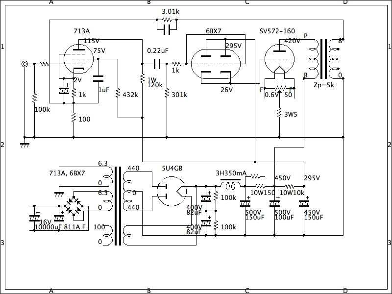

I have a number of SV572-160 tubes and wish to build an SE amp but cannot locate a suitable design. Can anyone help in this regard? Alternatively, what is required to adapt an SV572-10 design, of which there are several available online, to work with the 160 version tube? I have built many tube amps but this would my first using a power triode.
I found these two in my collection of schematics but I did not check (if I even could) whether they are good designs or not.
I ran some SV811-10 on a modified Tubelab TSE. They worked great.
The Tubelab power drive (MOSFET follower) is definitely the way to go with the lower mu variants. I have some -160, but have not tried them yet.
I've attached the Svetlana sheet for the SV572-160 and a technical bulletin on the SV811/572 tubes.
Thanks very much for the ideas, schematics and data, none of which I had or could locate. Collectively, they should enable me to make a start putting together a design that I could make work. Must say I did not consider that the 160 could be pretty much the same as the 811A, so never looked at the data for the latter.
