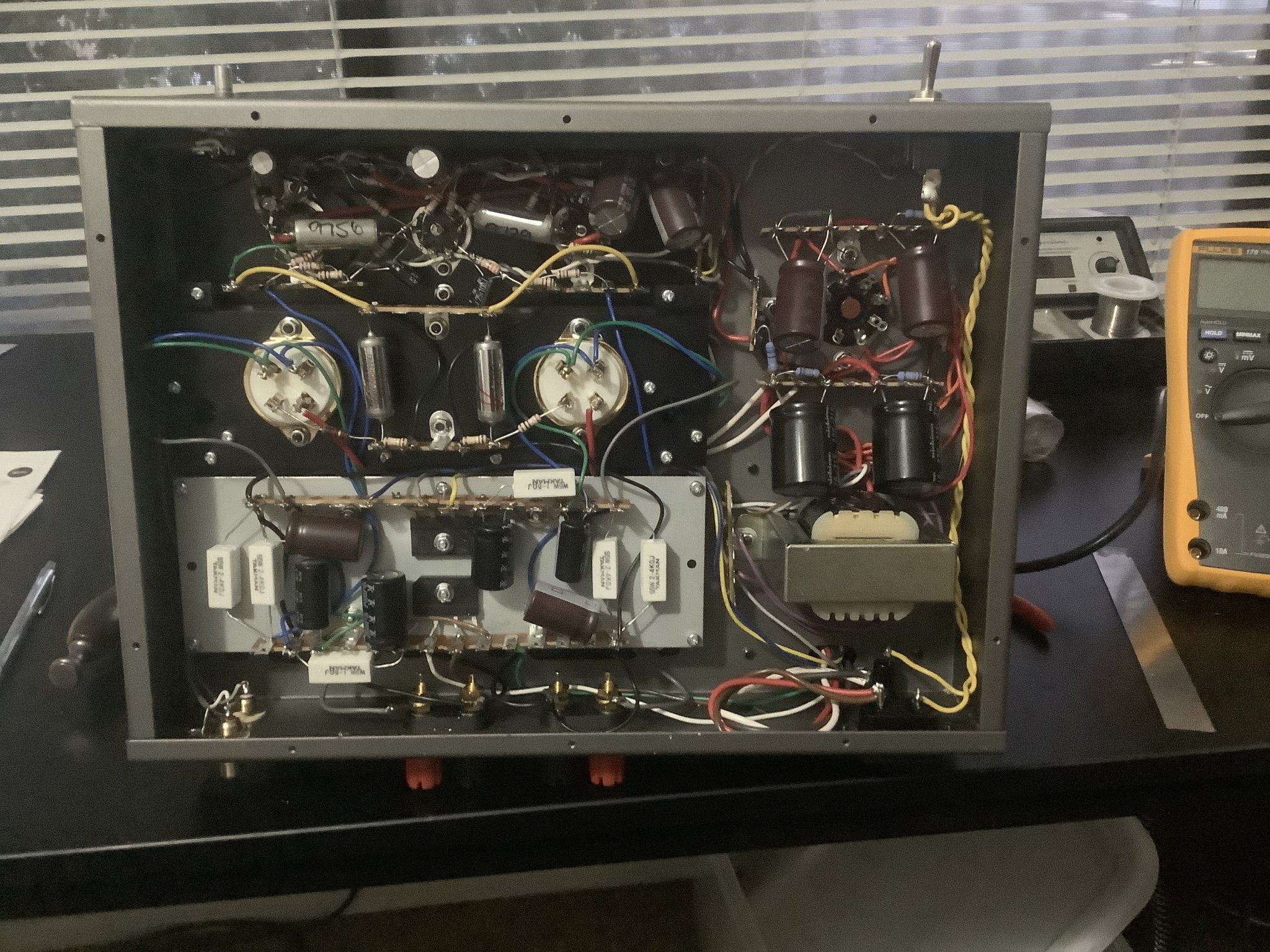

When I first got the kit, I thought I bit off more than I could chew. But I have gone slowly. Despite that, I caught at least two wiring mistakes during final review and sorted them out prior to applying power.
I have powered it up and nothing has exploded or caught on fire. So far so good.

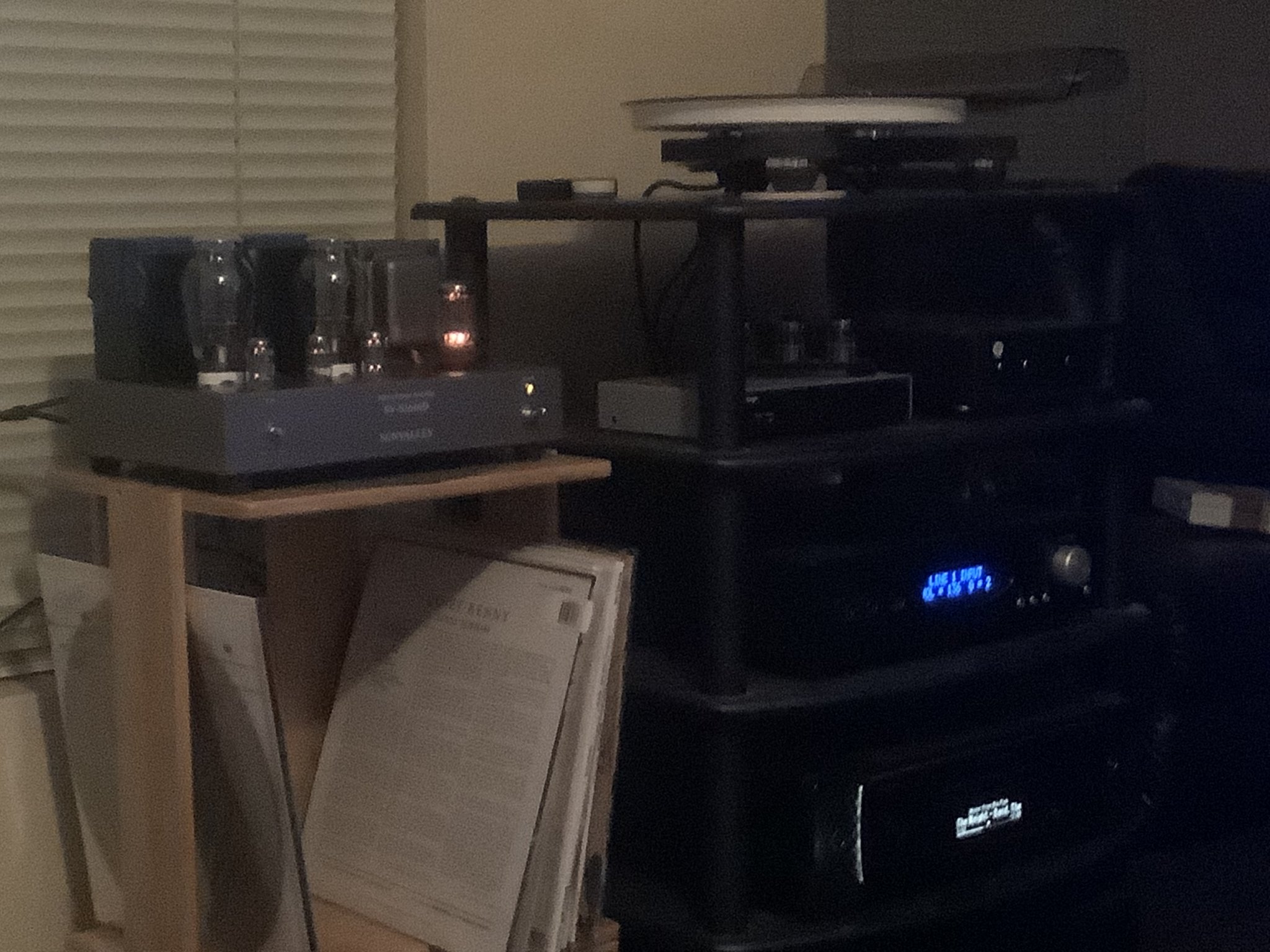

Well, I couldn’t wait until tomorrow. Plugged it in for a test run. Still haven’t put the good tubes but just had to know if it works.
It is producing music. Man, what a great and fun kit. Can’t wait to get it burned in. Will go back in tomorrow to clean up wiring with zip ties, put the good tubes in and enjoy.
Thanks again my friend. You are a pleasure.
Such an amazing amp.

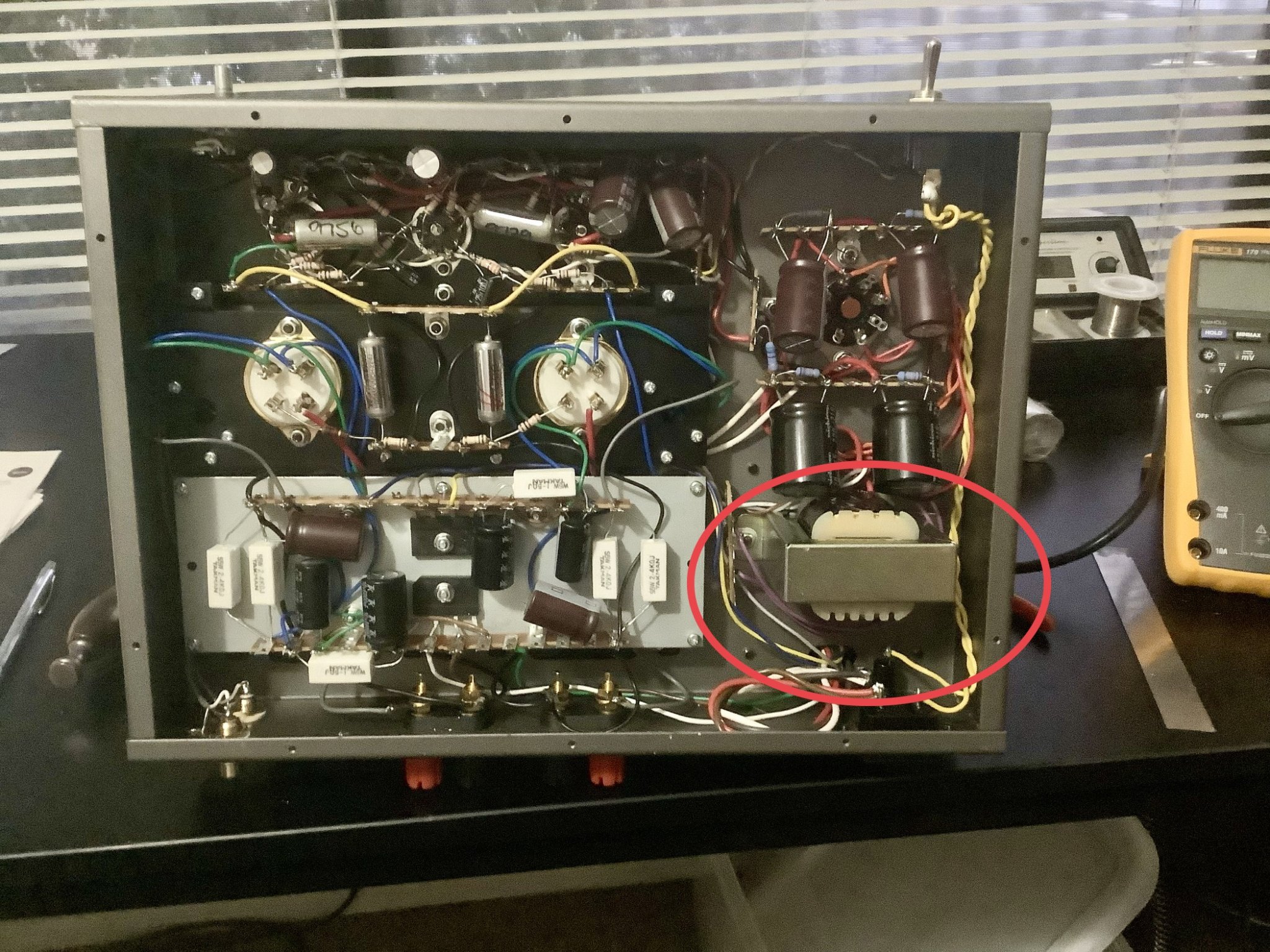

Curious, while I was doing my cleanup and looking things over - the circled item below - what is its function? Both leads run to the terminal strip going nowhere. Nothing else is connected. Is it only used somehow in 230v?
Hi. I think you are referring to the lite purple wires that go the terminal strip next to the choke.
Those are from the power transformer and are not used in this project.
Be careful with them. They do have high voltage on them.
