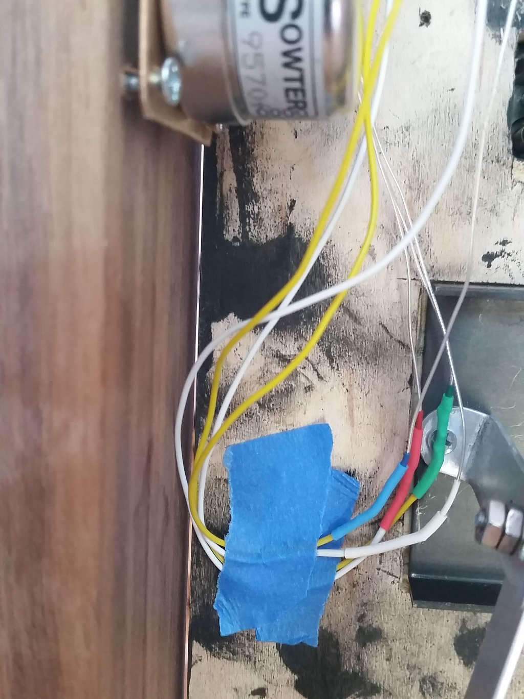

I have made all the connections as indicated but listening to my cartridge (Denon DL-103) the signal is barely audible, as if there no amplification at all came from the SUT. My only other cart is a MM so I can't make a comparison, but I did play the DL-103 without SUT and I recall that the level was similar.
The only somewhat unusual part of my layout is that I'm wiring the transformers directly to the arm wires, inside the turntable chassis. I double-checked the wiring and all seems correct, see image: hot L (white) and R (red) to white SUT wires, ground L (blue) and R (green) to yellow; pink to center pins of RCA jacks; mauve to ground pins.
Could something else be wrong? If it's a bad soldering I assume it should be equally bad in both channels because the levels are equally low. I can't test cart to primary because the connections are sealed as you can see (unless I cut the wires and restart).

Connections seem right. Perhaps try a load resistor on the cartridge side,
but this should not the increase level.
Denon DL-103: Load Impedance 100 ohms minimum (40 ohms when using a transformer)

Are you sure your preamp has a 47k input impedance?
If the preamp were set to 100R or 1k instead of 47k, then the cartridge would see
a far too low impedance, and the transformer secondary would be too heavily loaded.
What preamp do you have?
If you want a 100R load on the cartridge, you would add 100R across the cartridge side.
However, are you sure your preamp has a 47k input impedance?
If that were set to 100R instead of 47k, then the cartridge would see 10R, far too low.
I'm using Roy Mottram's PH-16. The impedance for my previous MM was 47K and I adjusted it to 100 which is the default suggested value for MC. So I guess I should adjust the preamp mipedance to 1K before adding a resistor?
That is the problem. The preamp input impedance must be much higher than 100 ohms to use the transformer.
Since the transformer changes the impedance by x100, and the minimum cartridge load is 100R,
you want the preamp input impedance to be 10k or more.
If you change the preamp input back to 47k, then the cartridge will see 470 ohms, which should be fine.
Try this first, with no added cartridge resistor.
To try it with the 100 ohm minimum allowed cartridge load impedance, also add shunt 127 ohm resistors
at the cartridge side. It will likely sound fine without these, though.
