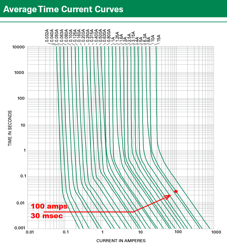

Best effort to protect put fuse for all 3 wires Ground, Netural and Hot(positive) and another 3 in the AC wall. Also you can use stabilizer. Donot forget lightning rods.
All the surge protector has to do is clamp the downstream voltage long enough for its upstream fuse to open. This requires milliseconds.
Placing a series inductor before the clamping device(s) was a cute idea, in my opinion. It slows down the risetime which gives the clamp(s) plenty of time to turn on.
