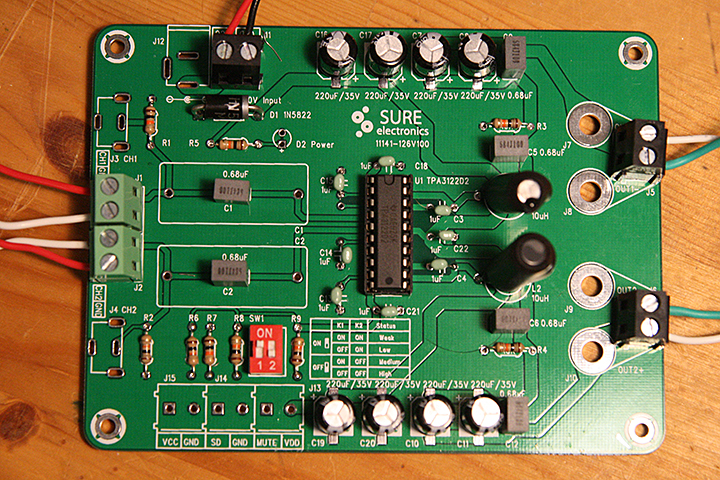

I have just finished putting together a Sure TPA3122 kit. It is working well. Sounds a little thin though. Any one have any thoughts on modifying it to get a bit more body, especially bass out of it. I am planning on using it in a small portable with a pair of Tan-Ban 3" full range drivers and a 12 l-ion battery pack.

In terms of minor things you can try. You could increase the value of the input caps (the datasheet at Texas Instruments shows 1.0uF). You could also see what the max rail voltage is with your load and see if there is head room there, just be careful not to blow it.
The datasheet shows this amp will run with in BTL (Bridge Tied Load) and since you’re building another one that might just be the ticket. That will allow you to get rid of the output DC blocking caps but you will need a balanced input source. It also doubles the power.

I would double or quadruple c7, c8, c10, c11. I think the caps form high pass filter @ around 100Hz. This may explain bass roll off.

I don't understand what's happening with c1 @ 2. There is a box around them with unused connector holes. Is this for an alternative larger cap? I couldn't find anything in the specs. I'm afraid I don't understand most of what I read yet.

Your right, the extra holes are for a larger size input capacitor (at C1 and C2) and adding a 1 film cap in those holes is a good idea. You can leave the one that's all ready on the board in place.
The biggest problem is the output coupling capacitors, as duc mentioned. The schematic shows two 220 mfd paralleled. That's too small to provide good bass to a 4 or 8 ohm speaker. The TI data sheet for this chip suggests 1000 mfd for a 20hz cut off with 8 ohm speakers and 2200 mfd for 20hz with a 4 ohm speaker for the output coupling cap.
I would think 1 mfd would be enough. Bigger is okay, but not required. A decent quality film type will sound better then a electrolytic.
I've just about finished my first project with this little amp and have one small problem. On start up it makes some clicking sounds through the speakers. When I turn it off them on again the clicking is gone.
Any idea why it would do this?

I don't have experience with that board. It may be normal for that chip when it first powers up. You could add a delayed relay to disconnect the speakers for a few seconds when the amp is powered up, but that's more work. I would only worry about it if it looks like its hard on the speakers when it happens. Do the speaker cones move excessively in or out when the click happens?
