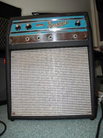

I picked up an old Supro S6616 from Craigslist for a friend in an other state. (1965)
The Tremolo works but it is stuck on one speed, so I told him I would fix it before shipping it to him. The Pot/SPST Switch has been changed but it tests fine. It is a 500K and it is a Linear Taper and its values change appropriately across the rotation. The amp is point to point wired so I traced all the wires from the Pot/Switch to the corresponding component. All in order. I also checked every value on all the resistors and caps in the Tremolo circuit, all within spec. I would think if there was anything wrong with the 12AX7, the whole circuit wouldn't work.
The schematic shows a 500 ohm pot but all the other Supro amps with the same circuit (especially the S6622), all show a 500K pot for speed in the Tremolo circuit.

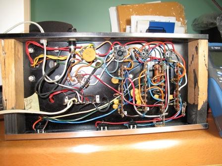

BTW, attached is a photo of the undersideof the chassis

Keith-
It looks like one of the PT bolts would be a good spot for a terminal (solder lug) strip if you have one handy. Then you could terminate the line cord there, solder in your caps, and carry the wiring along to the fuse/switch, etc. And no visible alteration to the chassis.
A 15 cent terminal strip is always a good excuse for another electronics order! ;-). (Steve at apexjr had some the last time I looked. Otherwise, the usual (tube) suspects will surely fix you up....)
Sometimes the hole in the lug strip needs to be drilled/reamed out a bit to fit the #10? PT bolt. Be sure to use a good star washer and extra nut.

Hi John,
With the new cord entering the chassis right there, that is a great idea... No added hole drilling to mount a strip! I am sure I can find something like you have pictured. I have to order the Pot, Power Cord (16/3) and some sort of chassis clamp (is that what they call them?) for the cord, two Safety caps and a small terminal strip anyway, so why not make it one big order. That is if I can find a similar pot to the original. That is a 500K Rotary Linear Taper Pot with a rotary SPST switch (not push/pull or push button) and 1/4" threaded sleeve by 3/8" split nylon shaft, at the same place that has the rest!
