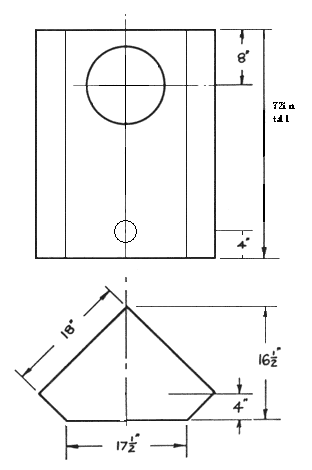

2.) Another design I'm contemplating is a pipe/blh with a Karlson vent:
http://gallery.audioasylum.com/cgi/gi.mpl?u=21168&f=PLAN.gif
http://gallery.audioasylum.com/cgi/gi.mpl?u=21168&f=PLANS-2.gif
http://gallery.audioasylum.com/cgi/gi.mpl?u=21168&f=BRACE.gif
(should read 1" x 4" bracing)
We built a pair of these before w/ oridnary ply and it sounds great with low Q drivers so far (tried with both FE207E and EX2's). I asked the designer (Bill Woods) who kindly shared it in the public domain for diy if a higher Qts driver like the S-vox would sound good in 'em. He told me that the only way to know is to actually try. Well, before letting go of considerable $ I'd like to know what you guys think. *He did a sim comparison Vs. JBL LE8TH using Akabak and sent me the response graph linked below. The dips are said to be artifacts of Akabak, but IME trying out high Qts drivers in backhorn or pipe designs is that they tend to sound boomy with midbass suckout. The not so encouraging part is that the designer says they LE8TH is quite bass heavy in that enclosure. Both the S-vox and JBL driver have very similar Q, although other parameters like Vas are far from each other: http://members.aol.com/IKSchiffer/jbl/bigbrother.html

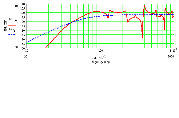

OK, here's what the driver looks in the Supravox TQWT.
To be honest, it's not too bad. This is a fairly quick model; I didn't refine to the 'nth' degree, but it's as close as should make no difference. I deliberately applied no stuffing to the model -a small quantity will take out the worst of the ripple.
It wouldn't be my choice for this driver, as IMO, it's not got enough volume -one of the reasons it cuts off a bit high for my taste, but I wouldn't mind sticking a smaller unit in it -in fact, I checked it with the FE168ESigma, to good effect. Someone (Can't remember who, off-hand) on the board is in fact doing just this.

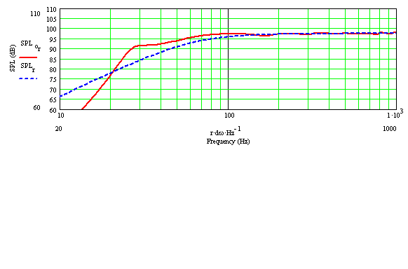

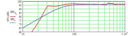

OK, here's a possiblility, if you've got the space. I came up with something similar a couple of weeks back for a friend with Coral Flat 10s, albeit rectangular, which wasn't ideal, but what he wanted. If you don't like the shape, you can make it whatever you want -just keep the CSA the same, or within a few percent of 236in^2. It's not small, but with driver's like these, you really need to have a sizable enclosure to get the best performance out of them.
I actually borrowed the layout and CSA from the original Tannoy Lancaster corner cabinet as I rather like it. It's stretched vertically to 42in tall (internal) though, and the big original rectangular vent is replaced by a single circular port, 4in diameter, 2in long, 4in up from the internal bottom. I'm lousy with CAD software (learning a couple of decent programs is on my to-do list), so I simply modified the original Lancaster drawing to reflect the changes. Sorry the internal length is so small -as I say above, it should be 42inches. 0.25lbs ft^3 of stuffing used in the top half of the enclosure.
And here's the FR graph. This enclosure is on the border between being an MLTL and a BR I suppose -whatever you feel like calling it, it seems to work pretty well -roll-off is in lock-step with room gain, so it should be pretty flat to around 40Hz or so, and it'll still by belting out notes into the 20s, no problem. Smaller versions are possible of course, but if you've got the space, this'd be one of my top choices. Pretty nice efficiency too. Give me a shout if you want something smaller & I'll try to come up with something.

I appreciate you doing a sim on the the Supra TQWT. I suspect the early LF rolloff is deliberate to avoid over-loading when placed near corners (?).
The Tannoy design looks sweet. The only problem I think is I've only got ~8.5' (width of the room) of space where the l/r speakers would be placed - too close to each other. Maybe a version that is narrower but taller? BTW, that's a textbook FR graph!

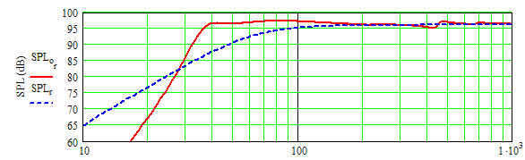

Now that looks very impressive indeed. How did you model the Onken in MathCad? Or am I asking for trade secrets there? (my apologies if that's the case).
Bigger cabinets are better? Now, who was it who has taught me that principle over the course of a certain other thread... ;-) Cheers Greg. You've opened my eyes to quite a bit.
Regards
Scott
Regards
Scott

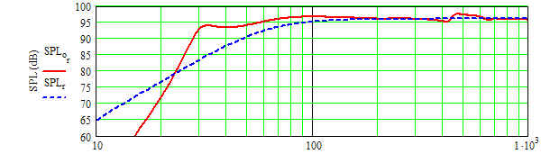

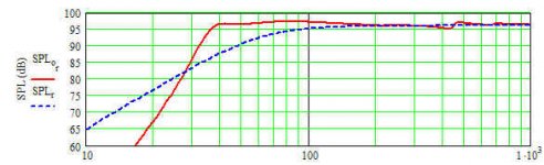

Greets!
You can't accurately model one in any program AFAIK, but assuming the specs are reasonably accurate it's close enough IMO. Anyway, nothing special, just run the numbers in an Onken calculator and use the PORTED WS. Since the vents are distributed along its height, just position the vent in the middle and calculate its radius based on their total area using whatever length the calculator says, then if you don't like it, change it to suit as I did with this one, hence the 'hybrid' moniker.
Here's the n = 6.34 Onken alignment I started with:
GM
GM
