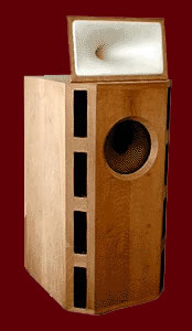

120-140 liter netto, with BIG slotport 100x400mm x100
I tried calculate with 275 liter and just a 100x400mm slot opening, not a port...pushes it down to 35hz
Have been used a lot in PA
Could be its a woofer well suited fore ONKEN, I dont know...but its suggested on Supravox site...dont know if its the optimum

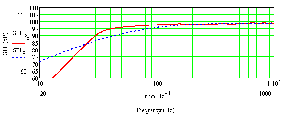

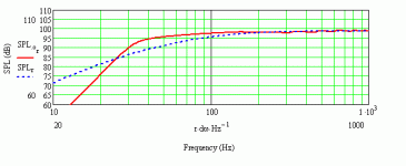

You don't specify exactly what sort of cabinet you're after, and 'best' is at, er, 'best' a subjective term, so we're going to have to wing it here.
Something like this MLTL ought to get you started:
42in long, CSA 221in^2, Zd = 17.625in, Zp = 38in , vent 4in diameter x 1in long.
supravox spec cabinet
Scottmoose, please give me spec in human language....i'm not familar
with ZP , ZD , CSA. thank you Claude
CSA = cross sectional area
Zp = distance of port centre from the internal top of the cabinet.
Zd = distance of driver centre from the internal top of the cabinet.
