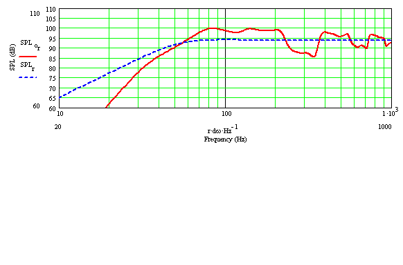

BTW, I saw these Supravox enclosures at MJK's site in his gallery page ('vast' indeed):
Supravox Model/Parameters

felixx said:What do you think about that?
Greets!
Hard to say since no width dimension is given. Is it specifically for the 215RTF Bi-cone?
GM

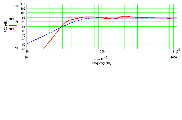

Greets!
As I figured, it has too little Vb, so while it's acoustic length goes down to ~41 Hz, it's so small that it's tuned to ~80 Hz, making it strictly a midbass horn, though with corner loading may have adequate bass.
GM

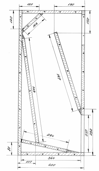

Another enclosure.....but I don't think on what freqv. is tuned.
What is the best suitable enclosure for 215rtfbicone ?........
......... to obtain a good balanced bass...........and rezonable spl.
http://www.supravox.fr/kits/tqwt215.pdf

Another enclosure...............also I don't know the frecv. acord:
http://www.supravox.fr/kits/tqwt215rtf.pdf
The other option maybe will be an closed enclosure with 80 L with nonparalel walls.

felixx said:Another enclosure.....but I don't think on what freqv. is tuned.
Greets!
I don't have time to keep reverse engineering every cab design you can find, but to get the 'best' bass performance out of this driver requires at least a ~216 L cab tuned to ~44 Hz, so figure the net Vb and if it's not at least this much, then you can assume it will roll off at some higher frequency and how 'balanced' it will sound will be based on the tuning frequency and/or how much EQ you're willing to use to flatten its in-room response.
The 80 L sealed alignment will roll off above 100 Hz, so a separate midbass/woofer system will be required.
GM
