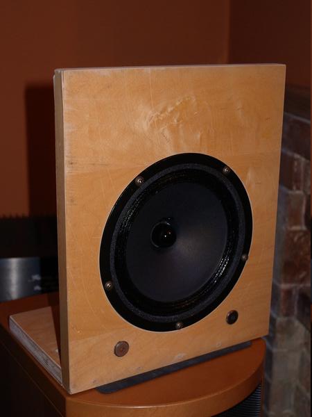

Nevertheless, I am quite impressed. I mounted them into a mini-baffle for experimentation purposes, and tried them in my office system, and then my living room:
I love the realistic sound, especially of piano, organ, drums, percussion etc. in the midrange.
In my livingroom I have an active crossover (Pioneer D-23) which allowed me to try them at various crossover points and slopes with the tweeter and woofers of my current 3-way speakers (which don't use the original active system anymore).

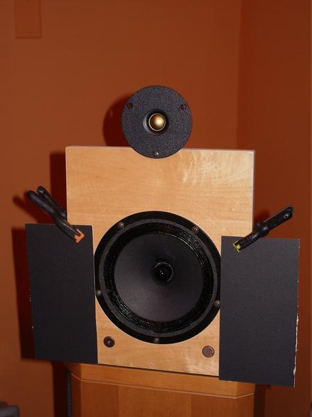

I used some boards to create a larger baffle, "boxed up" the Supravox baffle with some MDF boards and clamps etc. I definitely liked the Supravox on an open baffle the best, "boxed up" it lost its charm.
Then I added a Hiquphon OW3 tweeter to the baffle, which added the missing "sparkle":
and also took some measurements. With the baffle around the Supravox extended to about 15" width, but nothing added around the tweeter, the frequency response looked quite nice above 1000 Hz.

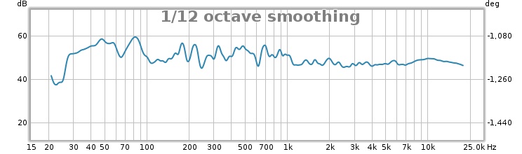

FR measured from listening position, pointed at tweeter:
My room is far from ideal, which is evident in the lower spectrum of the graph.

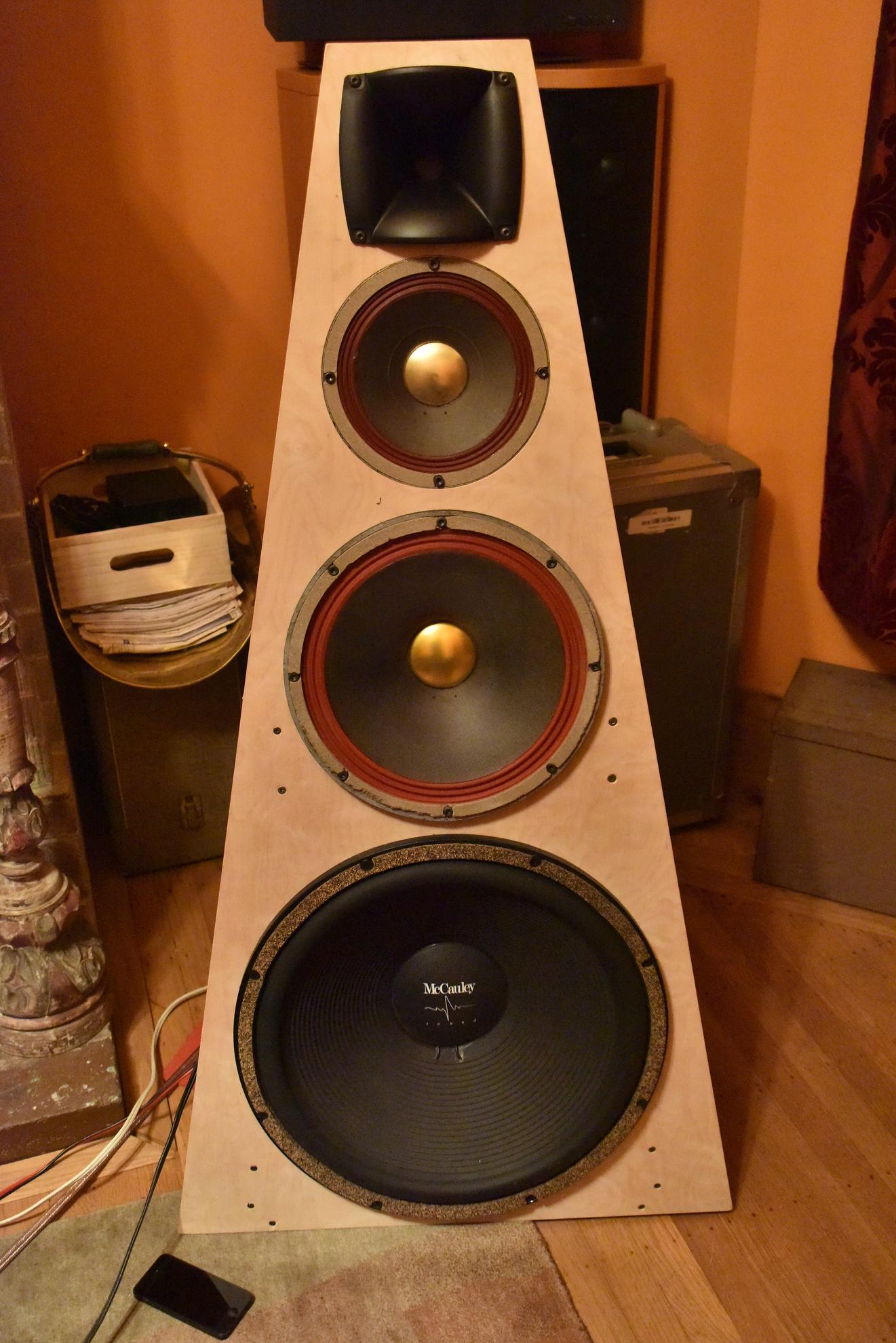

My thinking now is, to build "hybrid" open baffle 3-way, similar to this design:
... with the Pioneer active crossover, which I eventually intend to replace with a DIY active crossover (I just started reading Douglas Self's book on active crossovers).

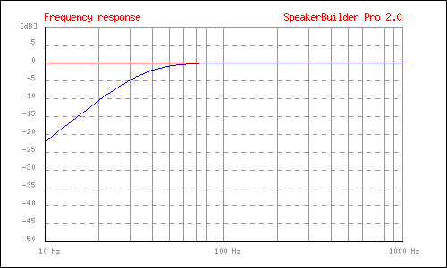

I believe the ScanSpeak Discovery 30W/4558T would work well. I modeled it in Unibox and also in Speakerbuilder Pro 2.0 and got pretty nice looking results for a box at around 55l and an Fb of 36.17 Hz:
The Unibox results looked pretty much the same.

2) Did I model the woofer correctly?

Attached is a pic of the latest test baffle. Note the size of the iPhone 5 for comparison...
I am really happy about the narrow baffle. It sounds much better than the wider one (about 22") that I was using before this.
