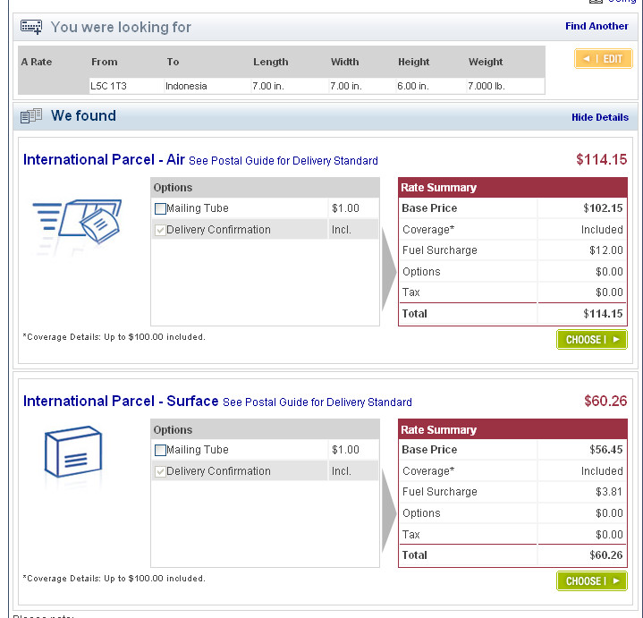

Here're the international shipping rates for a single transformer, are you still up to it?

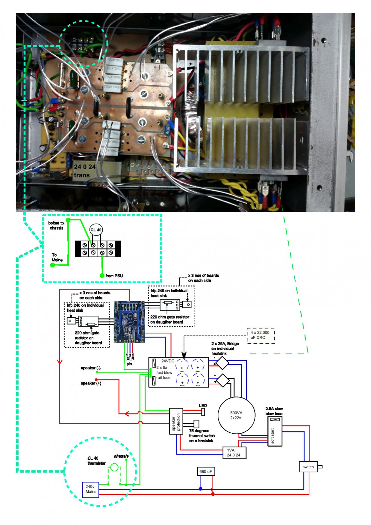

Hi Peter Daniel,
I'm using your AJ board for my mono blocks. Please let me know if I have made the correct connection to the xlr as I'm not using any rca. Do I need to connect SG to pin 1 of the xlr or do I connect the GND to the pin 1 of the xlr?

So you are using one board per channel for unbalanced operation, just the input is XLR, right?
In that case positive input to the amp goes to pad marked IN+, ground to SG and IIRC the pad marked as IN- should be grounded too.
GND pad is for connecting ground reference from power supply board. Also, ground from PS goes directly to speaker negative connector.
For balanced operation you need two of those boards per channel plus daughter board.

Merry Christmas to you and thanks for the reply.
Yes, one board per channel using just the XLR input.
Please see the attached drawing. Is this what you mean by grounding the IN- as well?
