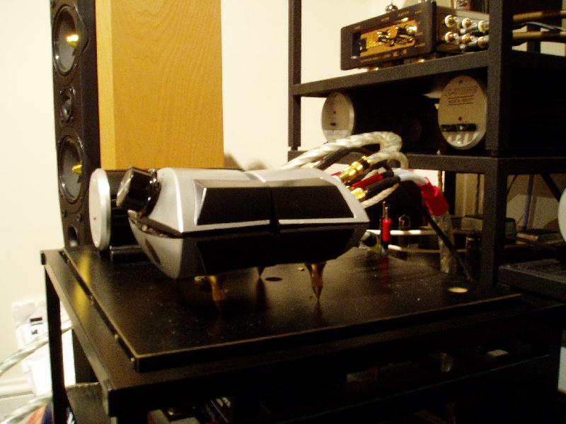

Supersonic T-Amp !
I must have too much spare time on my hands and too many spare carcases !
Hi Dynoforce. I thought that with the lack of response to my post the caveat was "nobody likes a smartass". Yours looks great. Is it modified inside ? Mine has the M.M "classic" mod and a soft start. I was humbled to have had a response from M.M (panomaniac)

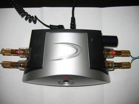

Just to blow my own trumpet, heres another angle.
Hi Puffin,
Thanks for the compliment. And I bet the Great Mothership can really play some serious horns.:sing:
I did perform the "stealth" mod, the C10 power cap (330uf) replacement and added offboard power caps (1000uF at the back + 8200uF beside the binding post on the right 😉 ).
Input caps are 1uF Nichicon FG while all power caps are Panasonic FC. Also, not visible are the rear RCA jacks.
This is my 1st audio related mod of any kind, and I am glad to have survived the many heart-attacks :yikes: while performing them.
I have not had the privilege to listen to or own high-end hi-fi, but this little amp sounds amazing to me. I guess my ignorant is bliss to me. :happy1:
Pano's website is like the T-amp Shrine :worship:, as far as I am concern. Many a times I have visited it and have my prayers answered.
Not to mention all the great tips I obtained from this forum. You guys are great. :grouphug:
