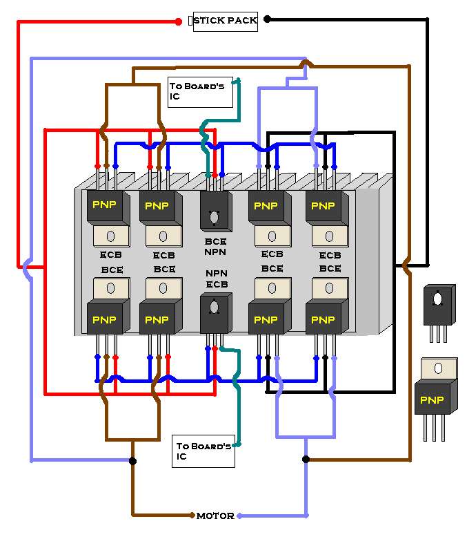

I notice that all you guys here have alot of experience on this electronic things. So I decide to ask you guys to help me check this little electronic R/C car's diagrams. Please teach me if you know a better diagram that can have more performance.

But you have to fill in with some more details.
What is the Voltage Power Supply?
What transistors are those?
How effective the circuit will be,
is depending of 3 things:
1. The power supply Voltage
2. How much Current the PSU, power supply can give.
3. What transistors you will use.
4. How those transistors are connected together.
The last is what you are asking.
And yes, you can change a little in the circuit.
But first let us have the facts, ALL THE FACTS & nothing but the facts.
I use a stick pack battery which is most electronic remote control car use, it can provide 12V 15A+(depend on batteries quality), but I can increase Voltage or Ampere it just like transformer's connection.
Normal power bipolar transistor, MOSFET also can be use.
I'm not really understand how transistor work, but I think it's work like controling a diod's current.
The diagram I want to build similar to power amp, just like increasing the output power of a power amp.
