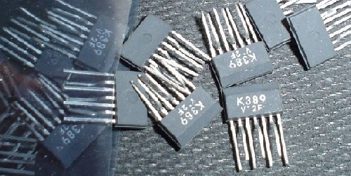

A couple of weeks ago i seem to have blanked the stock of $2.95 V-grade 2SK389 dual JFETs at Sound & Light Electronics (.net) in Southern California.
I noticed they list the A1538S at 3 two-bits the piece.(haven't checked where to trace the 2SC complementary parts in quite a while as i already have plenty)
These devices are obsolete, i got them from various sources and with floating supplies there's no sense in keeping records.
You asked for superb small signal parts, not easy peasy sources.

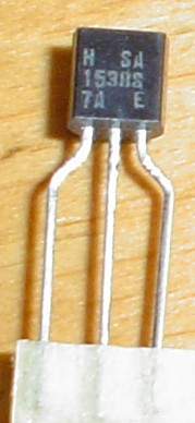

jacco vermeulen said:2SC2570 ? Shocks !
If you like it fast, just for fun : 2SA1538S/2SC3953S
400MHz/120V in TO92, not to be confused with Sanyo's A1538/C3953 in TO220 jacket.
(but don't bother to look for a datasheet)
