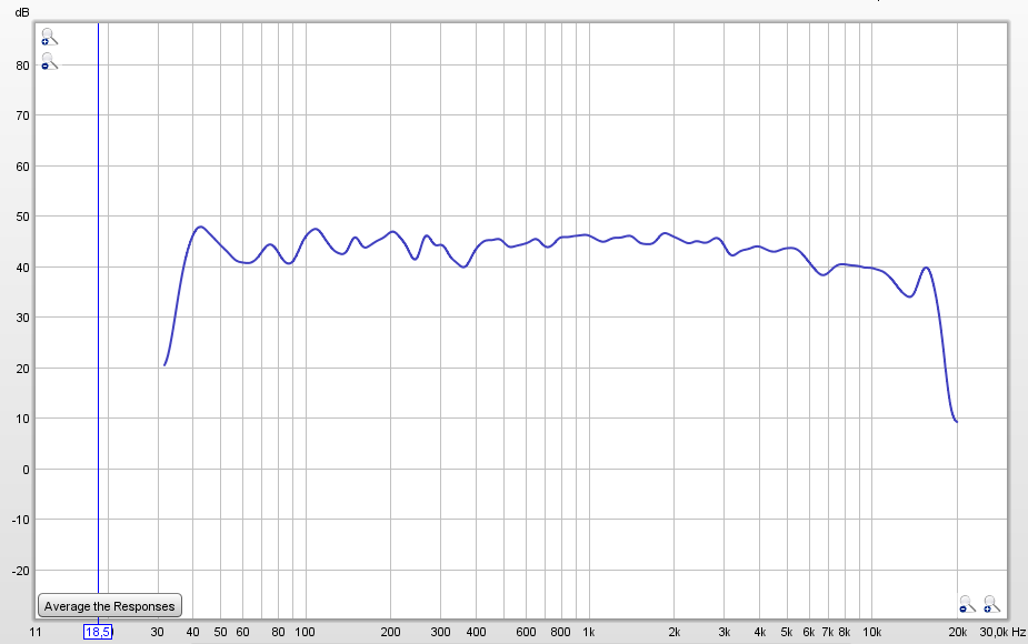

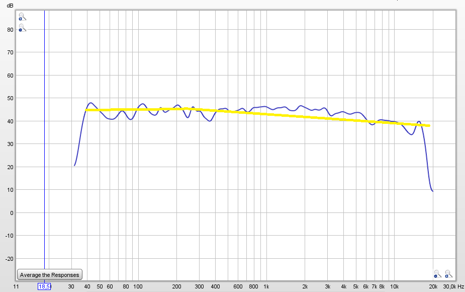

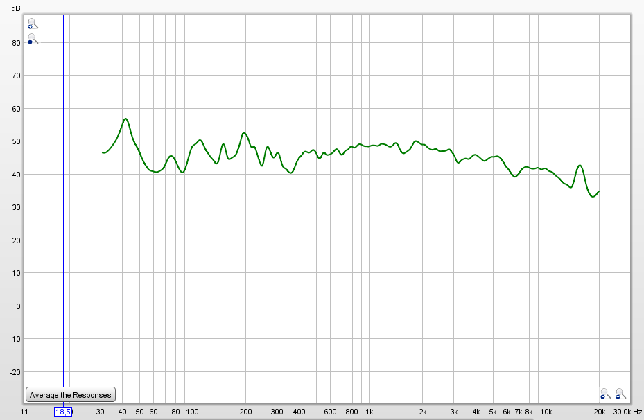

Some measurements with an uncalibrated mic.
L+R average no DRC:
attachment.php
L+R average with DRC:
attachment.php

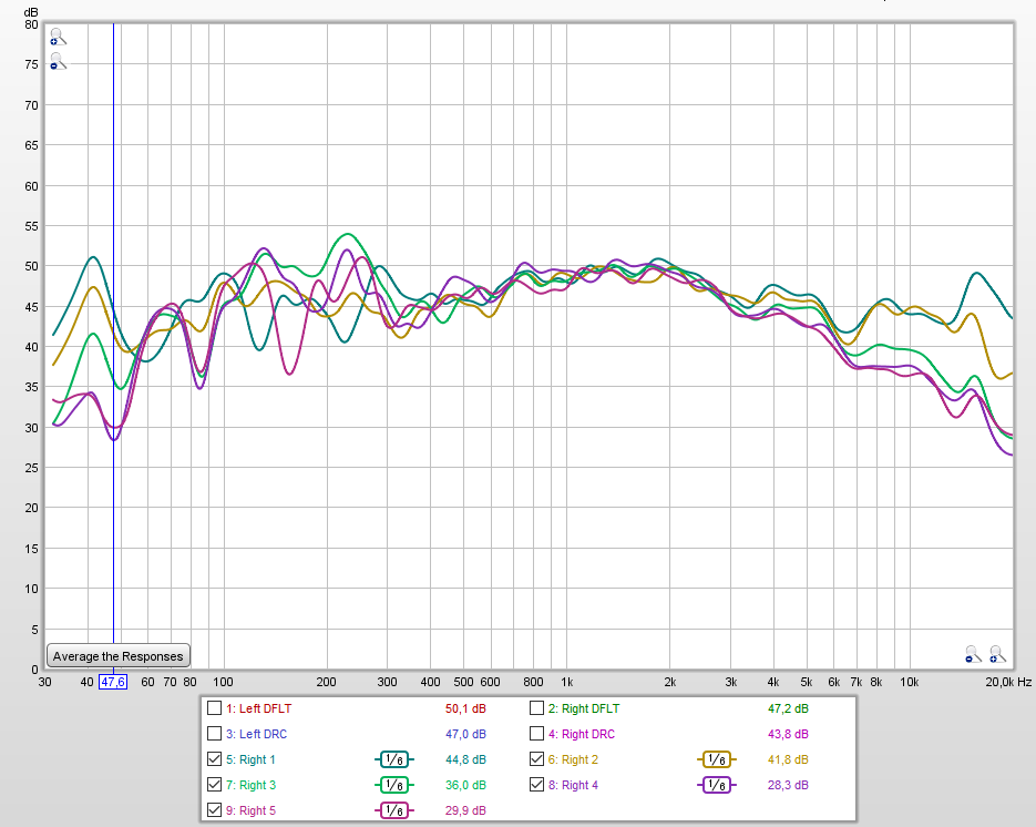

Right speaker, no DRC from 0 to about 40 degrees:
attachment.php
The room has zero sound treatment so it might not be the speakers fault that something is missing sound-wise. Thanks for your feeback, guys! 🙂
