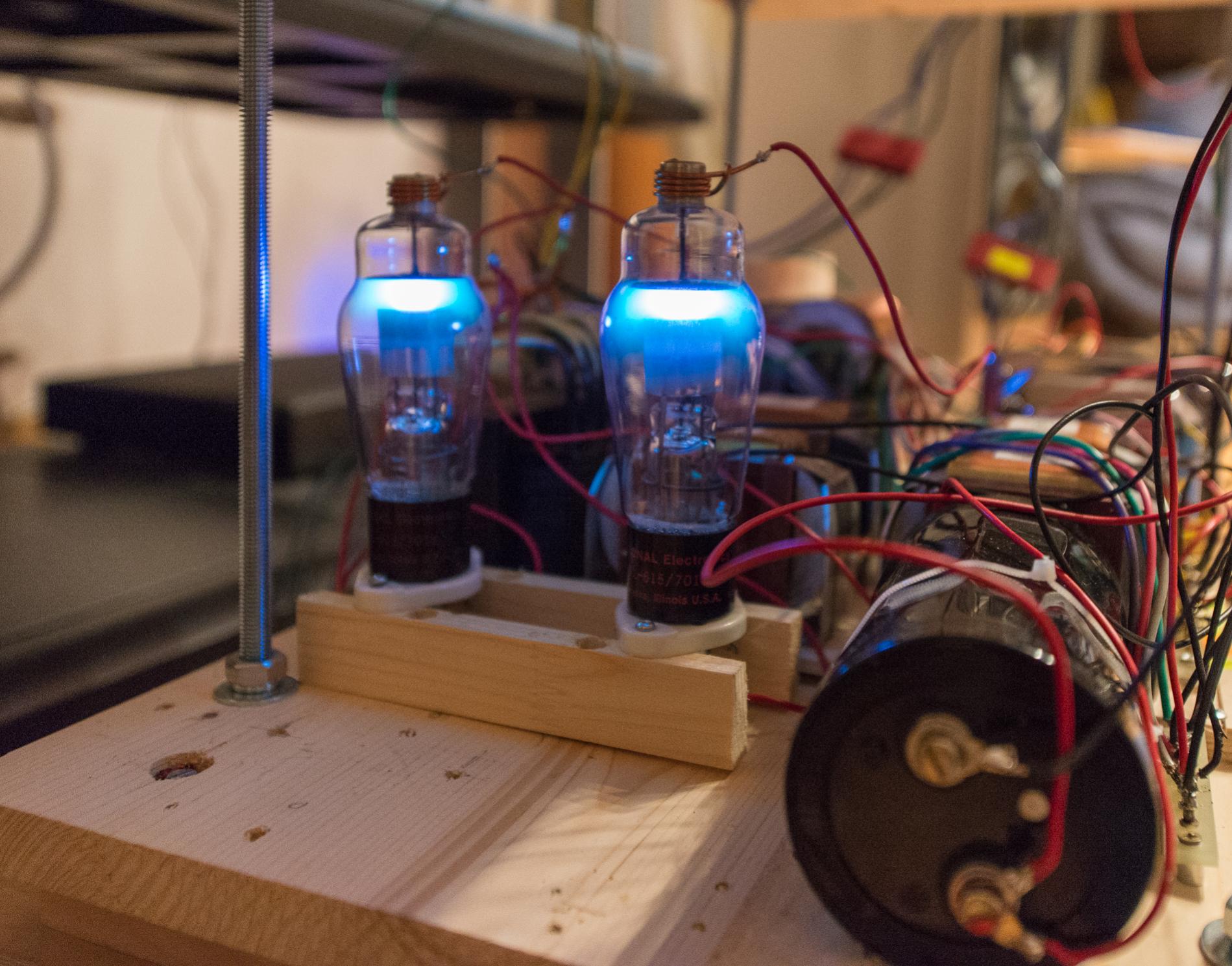

So, Triode as rectifiers means g1 to cathode or g1 open ? And Sweep tubes: g1 on cathode and g2 at anode I guess ? Correct ? Maybe I will play with this, I am just building a universap PSU to test drive all kind of setups...

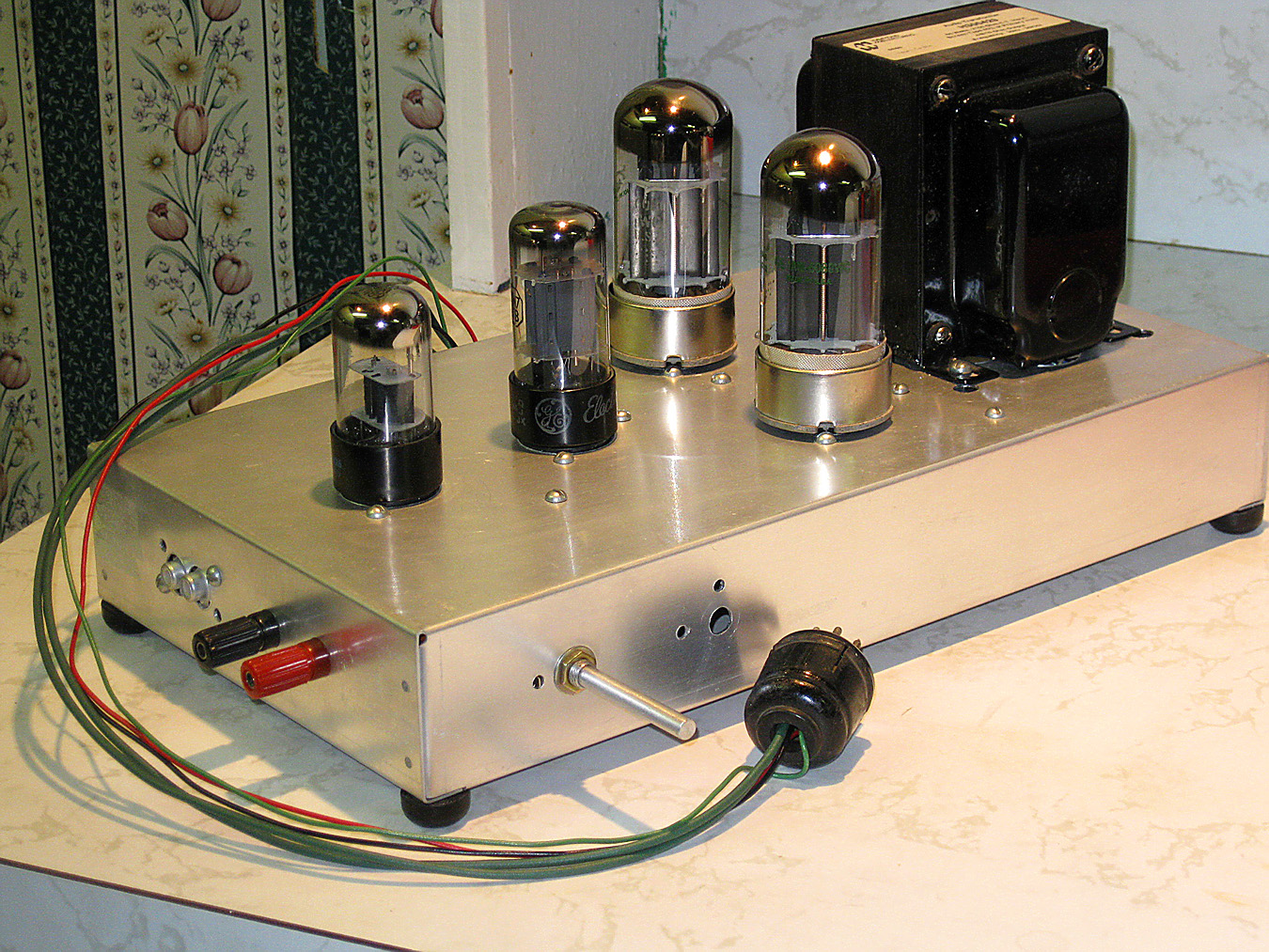

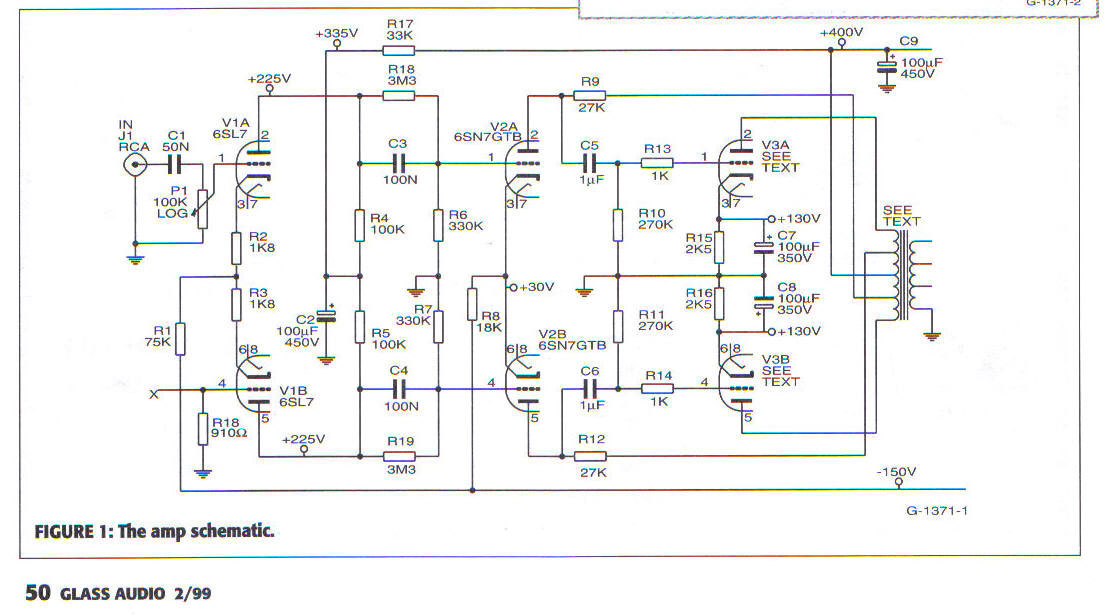

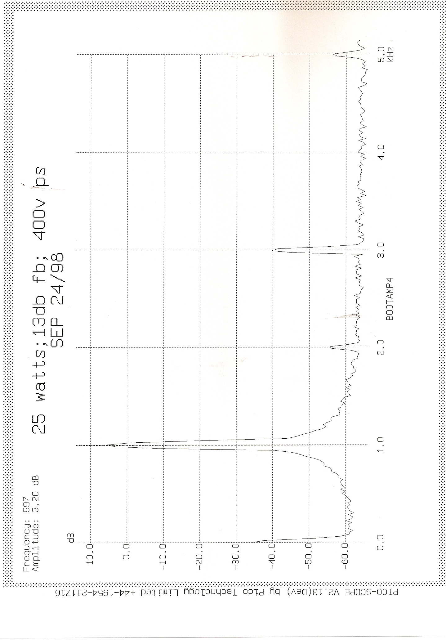

6AS7/6080 works well as an amplifier also. The very large cathodes are a plus. Here is my run at it. 30W at klipping.
Published in Glass Audio #2, 1999

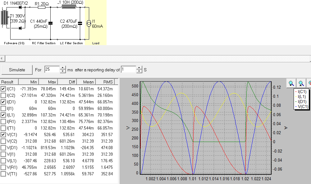

This is a choke input supply, despite the R and C before the choke. This layout has worked for me in low Voltage bias supplies and high current SS amp supplies. Also check out the fleshed out version here. The devil is in the details and the values need to be right to get the best results.

There is a lot more involved in making a power supply not egress anything more than DC voltage than just 'diode rolling'. The link includes a discussion on the influence of diodes and diode commutation - effectively focussing on the area of the power supply before any filtering and regulation normally start.
https://www.dalmura.com.au/static/Power%20supply%20issues%20for%20tube%20amps.pdf

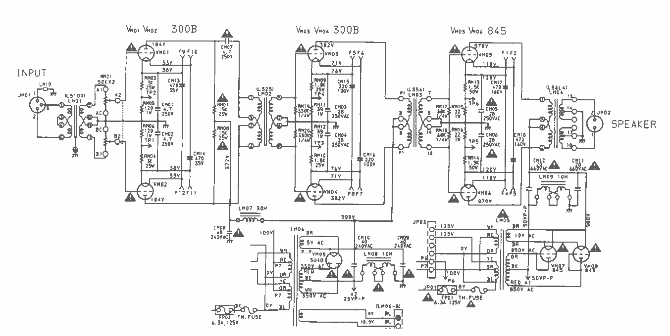

The venerable Marantz used 300Bs as rectifiers, right? Perhaps made sense as practically everything in that amp was done right.
I still somehow doubt this approach beats good mercury outside of sissy pc company 😛
That's news to me. Must be something new made by VSAC or in Japan I guess. Nothing made by Marantz back in the day used 300B as rectifiers, damper tubes, selenium, and silicon were used.. Tube gear in those days was engineered, there were no boutique makers here at the time.
The 211 was widely used as a rectifier because there were apparently no suitable high voltage high vacuum rectifiers until the early 1930s. You see this in early theater amps.
The grid and plate would be tied together.
