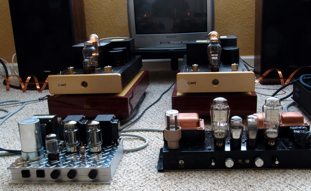

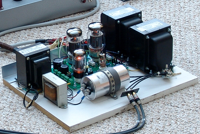

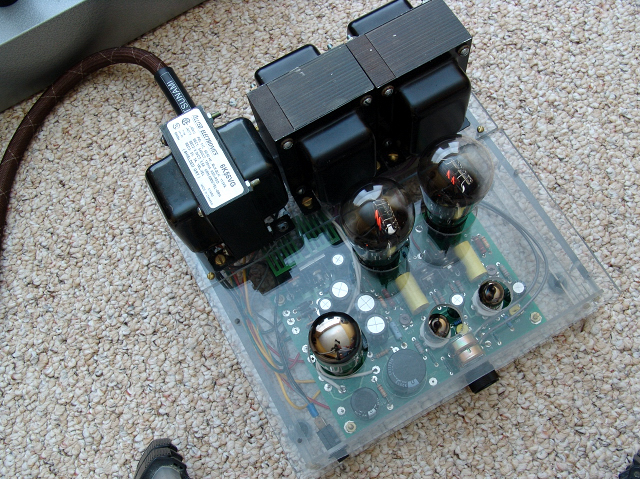

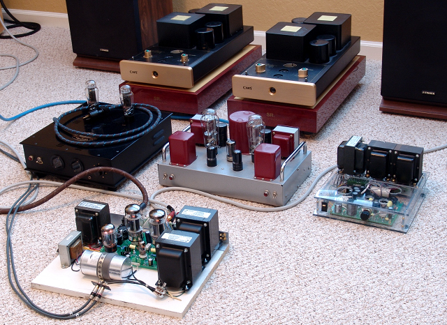

Pictures:
The "white board amp" and the "plastic TSE" go to play with the big boys (late 2006).
Last picture taken a year later:
The SSE gets some clothes.
