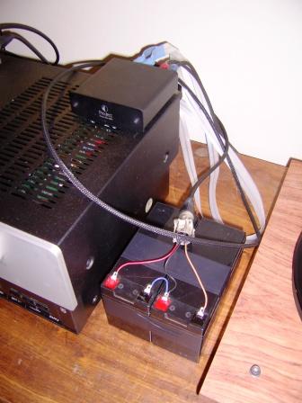

The Phonobox II is powered by 16v AC from a wall-wart tranny. Some audiophiles are appalled by this configuration so I thought I should for once address the "problem".
Opened up the unit and scanned around the PCB... found the two little chips (full of smoke). 79L15 & 78L15 IC regulators, which attempts to filter and smooth the half-wave AC from the single feed AC supply.
I carefully removed the two (yes only two!) diodes that divides the single phase AC current into two out-of-phase half-wave feeds. Also removed the AC input jack.
A nice cable was prepared and carefully soldered in place to feed the two regulators with < [+] [GRND] [-] > from the two 12v (-12v 0v +12v) batteries.
Wow! Am I surprised by the increase in sound quality! Look, the Phonobox II is actually a bloomin good RIAA pre-amp compared to pre-amps costing tenfold. (These days every pre-amp designer uses Op-Amps anyway... there is only a few left that has the guts to design a pre-amp using discreet components).
The sound-stage projected by the speakers suddenly has air and is almost tangible. My blasted hum is virtually gone and overall sound is inviting!
I am very pleased I took the plunge at converting the Phonobox. I wanted to do so for a long time but was scared. The tinkering with pre-amp building taught me one thing for sure - how a regulator looks and works! So there you go!

Nice! Have you considered building your own diy power supply for it, or will you just leave it running off of the batteries?

Luckily I have a lot of these "alarm" 12v batteries and will continue to use them. That was the idea from the start.
I will look into building a simple mains PSU for the phonostage but for now I am happy!

The only reason that miserable thing sounds good are the batteries. Nearly impossible to get any PS/regulator to sound the same.
The "battery" sound is very impressive in immediacy, air and detal. There are some shortcomings though.

In comparison to what reference are you calling this thing a "Super Audiophile Phono-Stage "?
It is not bad for the money in comparison to commercial options, better once some modifications are done to poor quality filter components and quite listenable but audiopile? Depends on what that means to the individual I guess.
Compares well to tenfold the price? What have you tried? For one the Clearaudio Smartphono craps all over it for say 3* the price. At ten times the price it is another ballgame all together and it is left far behind.

Dynamics are now better than ever as opposed to the crude AC system...
The thread name? Just to draw attention -
Yes, I am aware that there are designs that will whack it in the face but for now it sounds marvellous!

I do suppose one can build a quite fancy PSU for these phonostages that will equal battery performance. Try it.
Like I said - I have the batteries at my disposal so that is why I used them.

Glide, looking at the pics it seems you connected DC in the pads left by the diodes?
That means you are feeding 15V regulators 12V, this would not work properly and they would certainly be starved. It probably works though because for some bizarre reason project bypassed the regulator inputs to outputs with some resistors of a few hundred ohms though I know not why...
You may wish to remove the badly behaving starving regulators all together, or replace them with types that are at least 3V below your battery voltage, or up the battery voltage to at least 3V above the 15V regulators.
Or at least, remove the resistors and feed directly to the OP amp PSU pins through the pads left by the resistors. Leaving the regs out of circuit. This would loose the miserable small smoothing caps though.
Those teeny regulators starve the poor stage anyway, I replaced them with a little dexterity with TO220 versions and got rid of all the ceramics in the RIAA.
