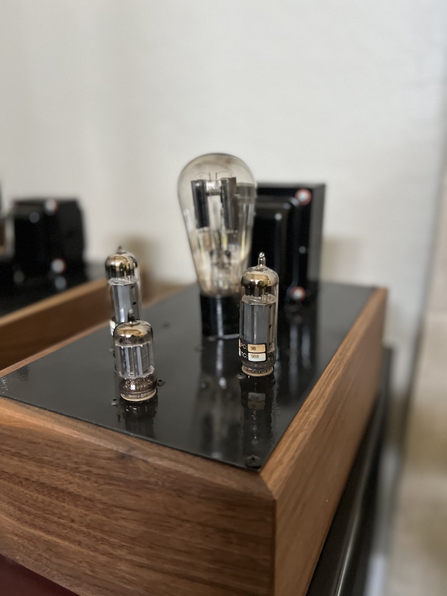

I haven’t built any of the Elekit products for that reason. When the B+ is in the right range, a 80/ 280 is what I use in all of my builds. For that reason the 46 is an awesome amp powered by that rectifier. Here’s a SEP EL-84 I built powered by the amazing globe 280.
Thanks for being very thorough and doing a tube rectified project. I’ll bet its a great sounding amp!
