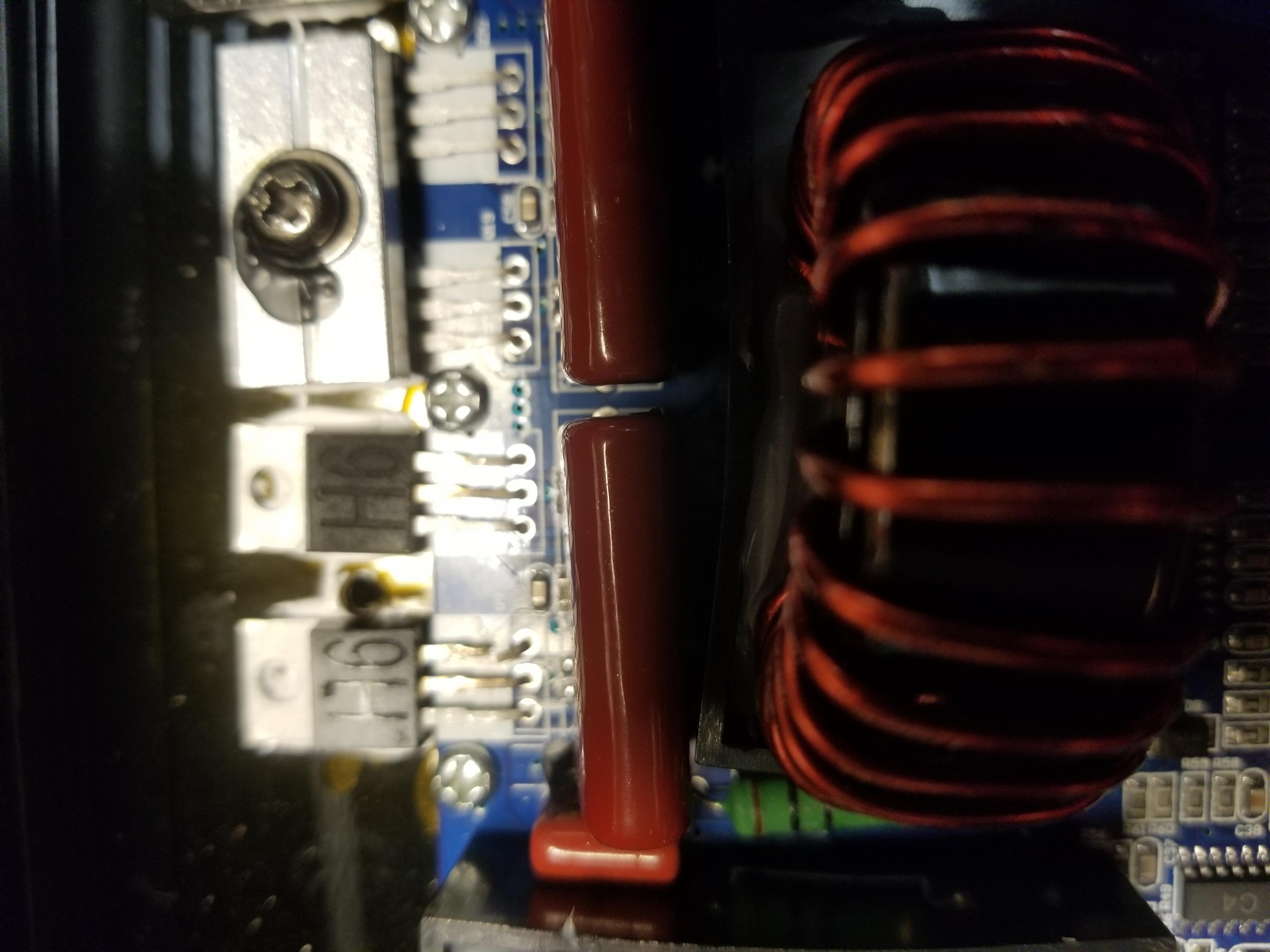

Also it may have knocked out the driver IC. Opened a resistor to what I assume is the drive output. Designation is C5. Anyone know the number for it as well?

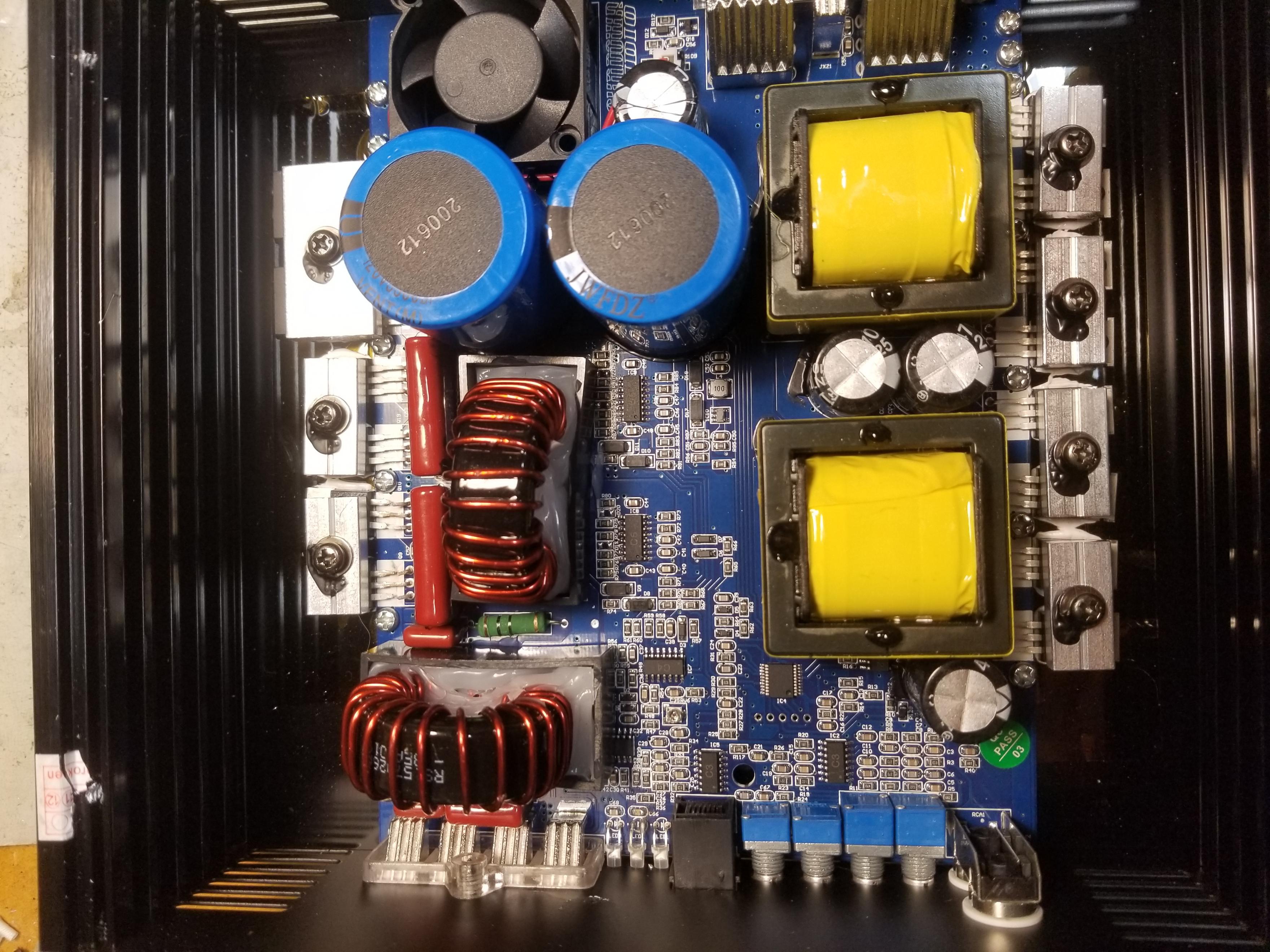

Post a photo of the entire board. It appears to be a brazillian clone. If so, someone may recognize it.

Mario - do you know what IC7 is? PWM chip?
If all is working is there a way to force drive to the output fet gate with no outputs installed?
If I understand what he means, it should be LM319. In Soundigital amplifiers they are screen printed as "PROC1".Mario - do you know what IC7 is? PWM chip?
Unfortunately I don't know if there is a way to start the amplifier even without the output mosfets, I suppose that the microcontroller expects a PWM signal from the outputs to be able to correctly enable the "correct operation" state, then at power on , makes a "check", checks that the rail is generated for a good portion, if it does not, stop everything, if it does, proceed to the next step, where it checks that there is PWM at the output, if there is, it remains lit, if there is not everything stops.
What I can advise you is to install the mosfets, if the microcontroller of these Chinese clones works like the SOUNDIGITAL microcontroller, you will not burn anything, the amplifier will simply protect itself ...

Austin2022, the output fets are as Lenin89 said, CSD18502KCS. In a pinch you might try IRFB4115.
input or output i am asking about input?Austin2022, the output fets are as Lenin89 said, CSD18502KCS. In a pinch you might try IRFB4115.
