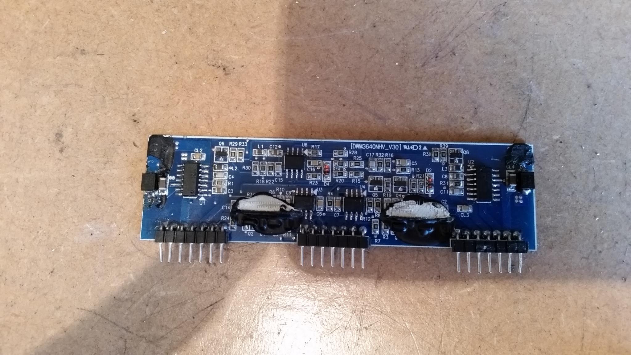

i have a sundown 3500 that came in with shorted outputs, the amp was working perfectly but was stored for around 9 months, when the customer wired it back into the car it went straight into protect.
i have replaced all the outputs and the driver board, now the amp powers fine and when audio is applied it has a clean output till around 50% power then starts to pulse output on and off almost like it has audio then mute then audio then mute, if i turn the gain down the amp has clean output.

sorry rephrase, when driving the amp it pulses regardless of gain control position, yes like there is a problem with the output
When it pulses on and off, do you have continuous rail-rail oscillation on the output transistors or does the oscillation stop when there is no audio?
Please use the 'Go Advanced' and (on the second page) the 'Manage Attachments' buttons to post images. Posting them as you did causes the image to open in a new window. If someone is replying to your post and in the middle of a (possibly extensive) reply they click on the image to confirm something for the post, all text that they typed will be wiped out. For some, that will be enough for them not to reply or to post a much shorter reply. I try to copy all text before I click on an image to prevent the loss in case the image wasn't posted properly. Others should do the same but may forget to do so. Please use the method provided by the forum to post photos in the future.
There are two resistors driving pin 3 of the center group of pins. One is a high value, the other is a lower value (6-8-10k typically). On the leg of the low value resistor that is NOT connected to the driver board, is the audio constant (not dropping out) when the audio at the speaker terminals drops out?
Is the relay disengaging when the audio drops out?
the audio is constant at the resistor and no the relay does not disengage, could it be that ive replace the irfp360 with fda24n40?
I don't think it's the outputs with the symptoms that you've given. If it were the outputs, I'd expect that the amp would draw excessive current or the rail-rail oscillation would be irregular or intermittent but you stated that it was continuous
Do you see the rail-rail carrier being modulated (changing pulse width) by the audio when there is audio?
Do you see the modulation of the carrier when the audio drops out?
