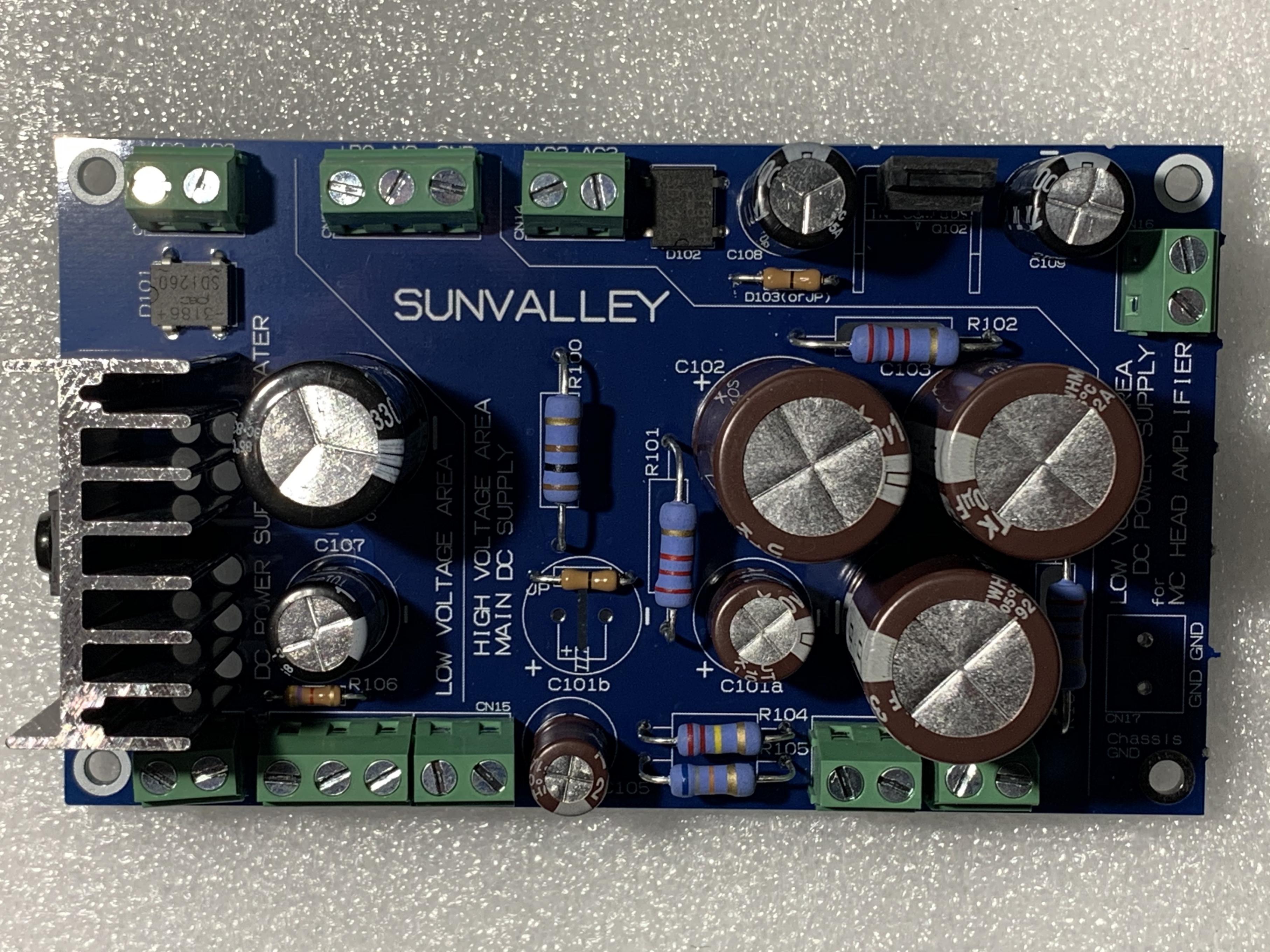

EQ1616D build
Completed the power board of the EQ1616D. Not difficult, but there was a glitch in the directions.
The parts list of electrolytic capacitors on page 5 does not include the 1000 µF 25v capacitor, or mention location C108. The diagrams on page 8 show location C108 with this capacitor. From the top view of the board on page 8, it looks just like the 1000 µF 16-25v capacitors at C107 and C109, so it’s easy to miss the difference.
