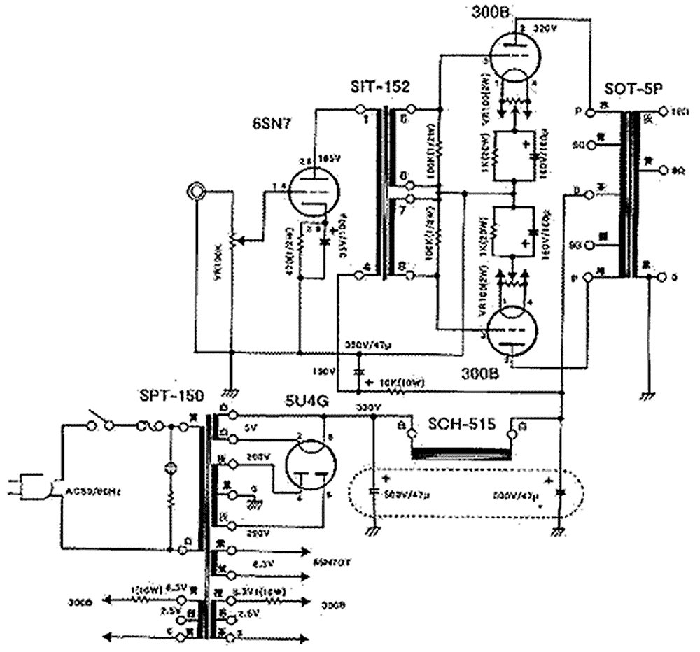

I sew some schematics given by Dr Gizmo :
SUN AUDIO SCHEMATIC
But they seem quite unreadable...

If you're using Windows, right click on the image and select "Save picture as..." then save in "My Pictures". You can then open it and blow it up and it then becomes more readable. Do the same for the layout drawing.
It really shouldn't be that hard to figure it out - its a pair of 300B's being run push-pull with an interstage transformer/phase splitter. Unless both triodes in the driver tube are being used in parallel I bet there's a significant step up in order to get a 6SN7 to drive two 300B's. Unless the interstage is something spectacular, its likely limiting bandwidth. Personally I think it'd be better to use an input transformer as a phase splitter, but what do I know?
The power supply is a bog standard "Pi" filtered full wave tube rectified supply.
Nothing exotic in this amplifier except maybe the transformers. The picture down below the schematic even gives you the parts values and layout.
If you can find out the specifics on the transformers you can build this amp. Run a simulation of a CLC power supply using Duncan's PSUD with the values listed and substitute values of chokes you can get your hands on until you get a power supply that you like.
Or on a Mac drag the picture onto PhotoSHop 🙂
dave
That looks much better. You can see that they're definitely using both sections of the 6SN7 in parallel to drive the 300B's.
Dave, what do you think the phase splitter transformer ratio is? 1/1+1 or higher?
It is definitely a step-up transformer, probably a 1:2+2. The 6SN7 is simply a very poor choice in this position and makes the requirements for the transformer rather extreme.

Some time ago i had the opportunity to buy a pair of these really cheap. I checked all opinions on-line and some were less enthusiastic. What really discouraged me was the non-standard Tamura iron and especially the outputs with no 4ohm taps. This is certainly not an issue with a clone. You may find though that getting a 1:2+2 interstage is quite difficult.
A few years ago i built a very similar topology using 2A3, a Lundahl 1660 for splitting an 83 for rectification and a 6S45Pi driver. The circuit is somehere at diyaudio. It was a very nice amp. The 1660 is far from ideal for splitting phase and unloaded rings like crazy. Took me a while to find a suitable snubber for the secondaries which killed the ringing but still let it sound ok. Apparently the Tamura splitter also requires loading.

They seem quite unsuitable for the circuit in question as they cannot carry dc in the primaries and they are not rated for the required voltages.
After some experimenting with various phase splitters i reached the conclusion that if a transformer is used it's much better to be ungapped and with either amorphous or nickel core. The cheapest solution is to use a low voltage unit such as the Lundahl 1544 used in the K&K's Dynaco and do the splitting at the input.
