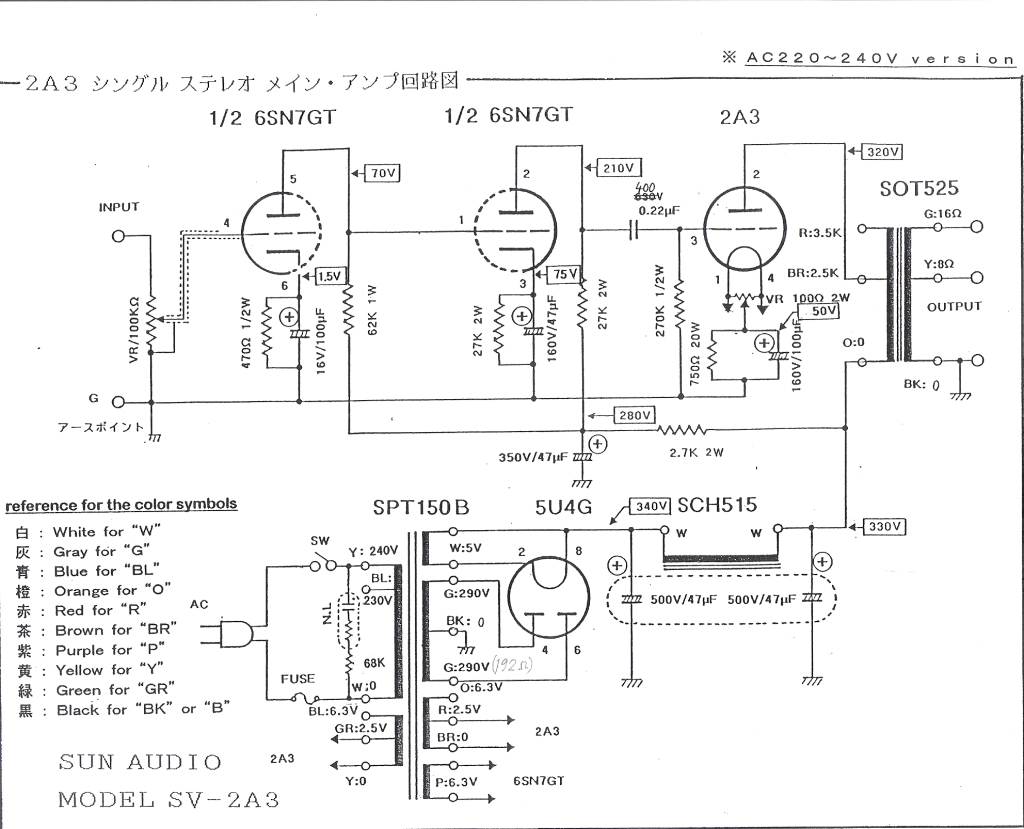

Hi all, I have Sun Audio 2A3 which really has too much gain. The schematic shows the 6SN7GT being used in 2 stages. To reduce gain could we just bypass half this input tube? Drive pin 1 instead of pin 4...
Probably other changes required but you get the idea...
Appreciate your thoughts.

You can't simply bypass the second triode stage because you will have lots of distortion, poor hf response and too little power output, the first stage only have 70V at plate it simply won't drive correctly the power stage and it will distort a lot, you will need to put a fixed resistor atenuattor at the input or to put a global negative feedback, if you don't want to redesign or modify a great part of the amplifier.
Also the first stage is dc coupled to the second you can't work a lot with that if you plan to don't touch it a lot.
You can - simply disconnect pin 1 from pin 5 and connect to pin 4.
Try this and see if you have enough gain....
HK
You will get no sound because triode 2 will be biased into cut-off. As audiowize in post #2 stated, the two triodes are directly coupled, and as such triode 2 depends on the DC anode voltage from triode 1 to bias correctly with its high value bias resistor.

My mistake and just deleted my post when I saw your reply. But you still can disconnect pin 1 from 5 and connect to 4, then change Rk to 1k8 and plate load to 51k, then see if you have enough gain.
HK
100k goes between input and top end of pot. That will reduce gain by 6dB.
The removal of the cap reduces the gain because of the negative feedback caused by the cathode resistor.
