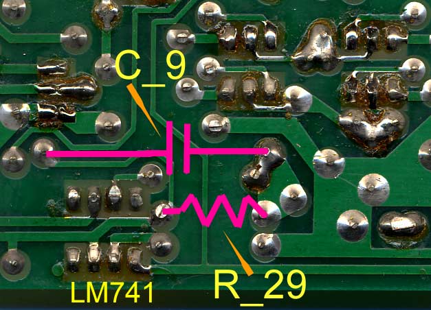

replaced the original MOSFETs with IRF'S -- initially the distortion was quite high, 0.50% but by adjusting VR1 and VR2 both channels match at 0.01% to 0.02%.
If you are replacing the original parts types, you might try using a better chip for U2 and a better cap for C9.
A 741 is hardly a low-offset IC, and something like an LF411 might be a better option. There are other types, but that might be easier to find and cheap too.
DC servos are used to eliminate the feedback large cap on the gain. But that doesn't mean that no audio is passing through any caps, as it is going through the servo cap C9. This cap should be a high quality one, preferably a film type. As that value is a bit high for such a type and you might have some trouble finding pcb space to hold it, a better eletrolytic should do it.

yes, when I dragged the '741 I must have crossed up the connection -- here it is on the bottom (the picture is "flopped")
The original Andromeda was BJT, the later one (not a Bongiorno design) was FET.
The BJT design sounds better and is more reliable (former Sumo dealer and service center).
Not that it matters, but the source and drain connections on the schematic for your Polaris are drawn wrong, as well as the DC servo.
