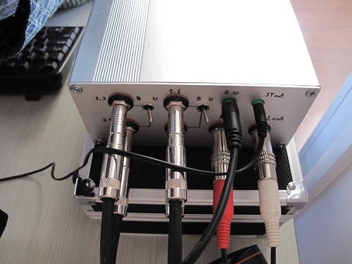

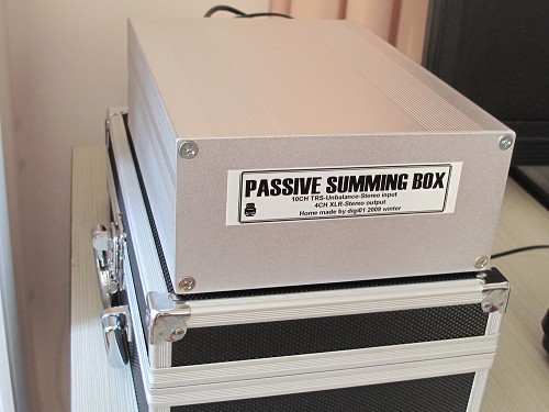

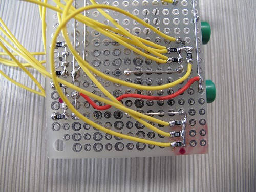

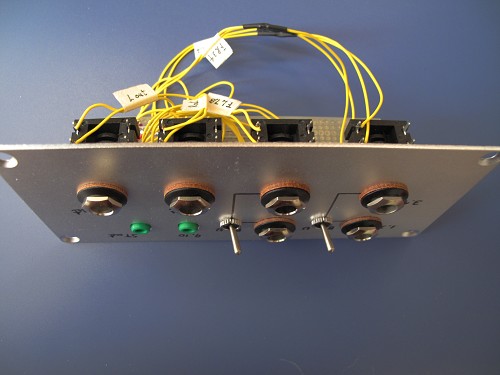

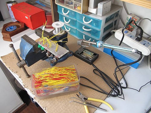

i make a 10 channel -4dB passive summing box,for hardware mixdown.
the below is some photos.have fun🙂zang
