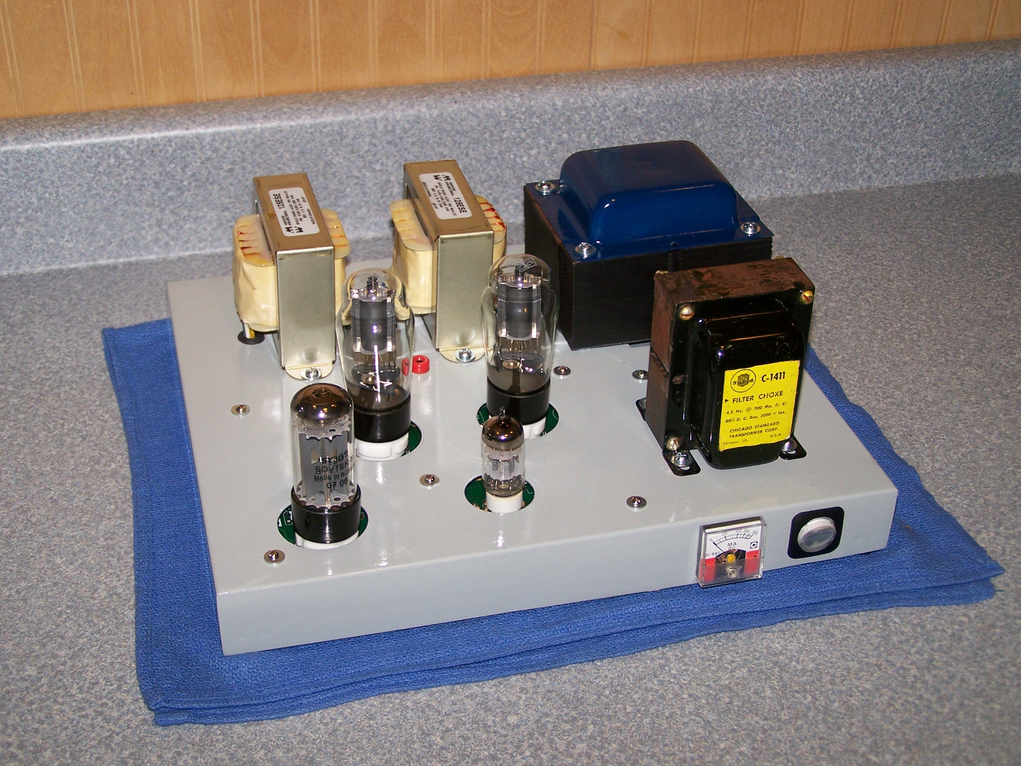

Summer is here in Arkansas, and to save on heat in the living room, where the Simple SE runs whenever someone is home, I've rigged it up for the little tubes.
Right now I'm running GE 6K6GT's and when I want to really save on heat, I go with 6G6G's, which sound surprisingly good within their limitations. After a trip to the warehouse the most powerful tube I now have at home is 5881 (excepting a pair of the cobalt blue Tesla EL34's - my wife really likes the cobalt color, so what can you do 🙂).
If you can use the little tubes in your Simple SE - give it a try. They sound great, better than the big ones, I think, although when set up for low power they sometimes lack the deep bass extension of some of the more powerful tubes, but they consume / radiate a fraction of the heat.

There are a few little power pentodes, i.e. 6F6, 6G6, 6K6, 6M6 (never seen one of these). These have the 7S pin out that is compatible with the Simple SE.
And little beam pentodes like 6DG6GT/6W6GT, 6V6, 6U6, and 6Y6 that have the 7AC pin out for the simple SE.
There is also a small Russian power pentode whose number escapes me at the moment (6S6S?) that turns up frequently on ebay. If you search "6F6" these almost always turn up. There may be other eastern bloc tubes as well.
All come in multiple styles like metal, small bulb GT style, and shoulder G style, except 6G6G, which I have only ever seen in a miniature shoulder shaped bottle, although the books list a GT style.
There may be others. They kind of fall into two groups: the 200 volt bunch: 6G6, 6U6, 6W6, 6Y6; and the 300 volt bunch like 6F6, 6K6, and 6V6.
My power transformer does have dual secondaries where I can easily run the little 200 volt tubes (mostly) within their ratings, but I've run 6K6, 6F6, 6W6, 6V6, the Russian tube, and even 6G6G in the low mid 300's without issue. A 5W4 has the maximum voltage drop of the rectifiers compatible with the Simple SE, followed by the american 5Y3, if you want to try some of these. The 5Y3 marketed by Sovtek is a nice tube but it's not a 5Y3 and has a much smaller voltage drop - it's more like a low current 5V4.

OK, a pic of the Simple SE with the Russian power pentodes sitting in it, and a shot of some of the "little" tubes with an EL34 for reference.
From the left: EL34, 6S6S, 6G6G, 6BQ6GTB, 5881, 6K6GT, 6W6GT, and 5992.

In my case I built a second amp. I used an Allied 6K56VG power transformer. It gives a B+ of 310 to 330 volts depending on tubes. I am still using a 5AR4. I use a set of Edcor XSE15-8-5K OPT's since these amps only make 2 WPC. The Edcor is great at this power level.
