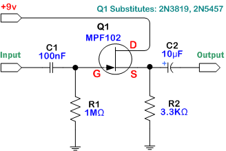

Thanks, KatieandDad !
I'm looking at this circuit:
Would this be suitable, repeated for each signal with outputs summed?

If each of your outputs have a low enough impedance, and the input you're driving has a high enough impedance, you can get by with 4 10K resistors, at least to try and see.
Look up summing op-amp circuit. It's an inverting amplifier, and by the nature of how it works all inputs are isolated from each other. This is how mixing consoles are made.
