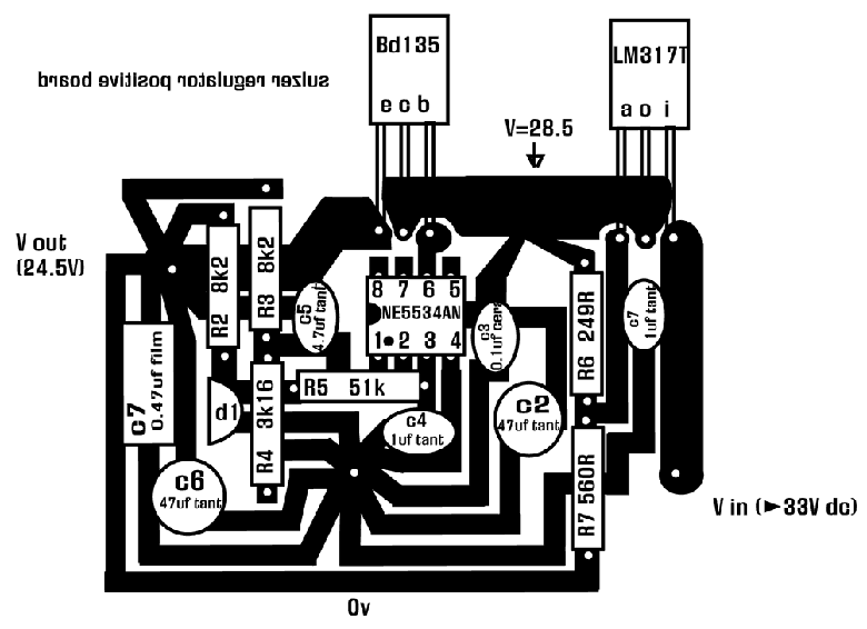

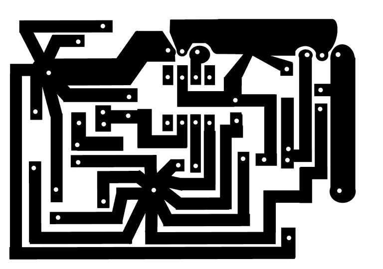

Star Grounding
Jan,
thanks for the tip. I've tried redesigning a positive sulzer board as you suggested with rigorous (think that is the way it's spellt) star grounding and was wondering if you (or anyone else) might comment on it. Is this what you were thinking of or does it have any obvious faults? If it seems ok I'll cook one up in the next couple of weeks and see if that works.
It uses a tracking prereg providing 4V headroom for the circuit, outputs 24.5 V and has R2 matched to R3 as I read somewhere that it aids DC stability and drift. Output transistor is a bd135 but that should be ok, shouldn't it? D1 is the LM329cz.
Cheers
Cedric
