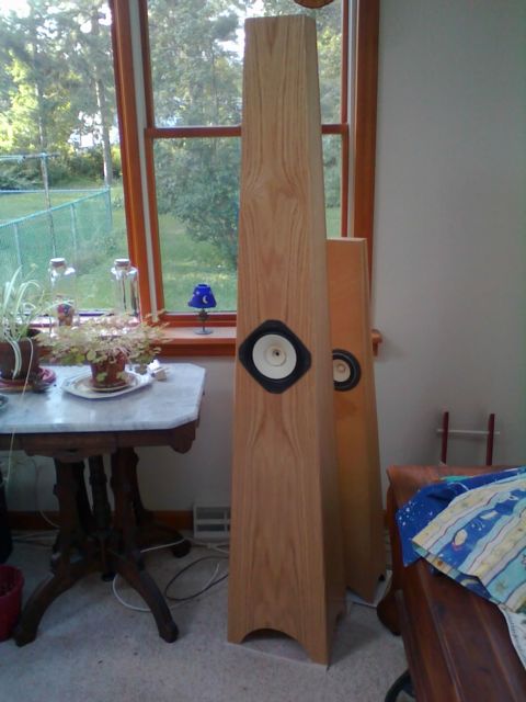

How about a Metronome with a Fostex FF165wk? 92 dB sensitivity may be enough for a 3 wpc amp. And I have found that females seem to like to look of Mets.
Photo shows my FE167e Mets standing in front of FE108eSigma Mets.
Cheers, Jim
Cheers, Jim
