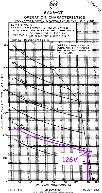

6AX5GT if you want Octal.
It is quite odd to specify the AC when what is really wanted is a DC result.
6AX5 is mighty similar to a 5Y3 and 140mA is a LOT for that type.
Plot it. Yes, 190VAC and 140mA DC is legal, barely, and mighty sagged.
Isn't that the point do using tube rectification? 😀
