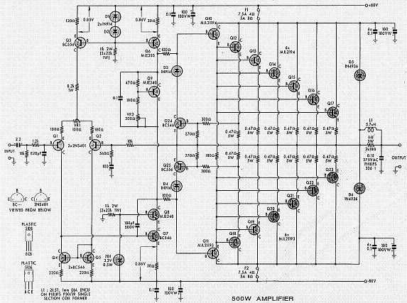

i need a suitable equivalent to mjl21193/4,but something cheaper.........200W,250V,16A.....
it is to be used in a amp,(+- 90V,but i think i will increasse it to 100V...)

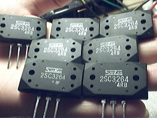

PD: This handful of Sankens are all fakes, be careful...

So much cheaper ? Sounds like a big risk of gettig some nice counterfeits !
Where do you order these ?
As you can see on Eva's pic, the fact having printed "sanken" on it means nothing !

Well, not all Sankens are fakes, those of the picture are all genuine devices, altough they come from four different production batches and require manual matching. Spanish component dealers are quite incompetent
Also I wouldn't be so concerned about SOA if I was you. Two pairs of these have survived flawlessly a test with 85V sagging [75V] rails driving a 4 ohm 15" horn loaded driver [reactive load] with music LF signals at full output swing [And I think two pairs of MJL2119x would also survive]

HERE IS THE AMP,BUT I HAVE MADE SOME MODIFICATIONS TO IT...
