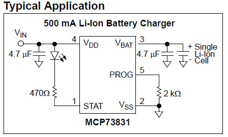

You can also try a stack of Lithium Polymer batteries and a bunch of charger chips like
Microchip MCP73831 which are about $0.80 each.
Fast Multi-Cell Charger | Multi-Cell LiPo Charging | Adafruit Learning System
