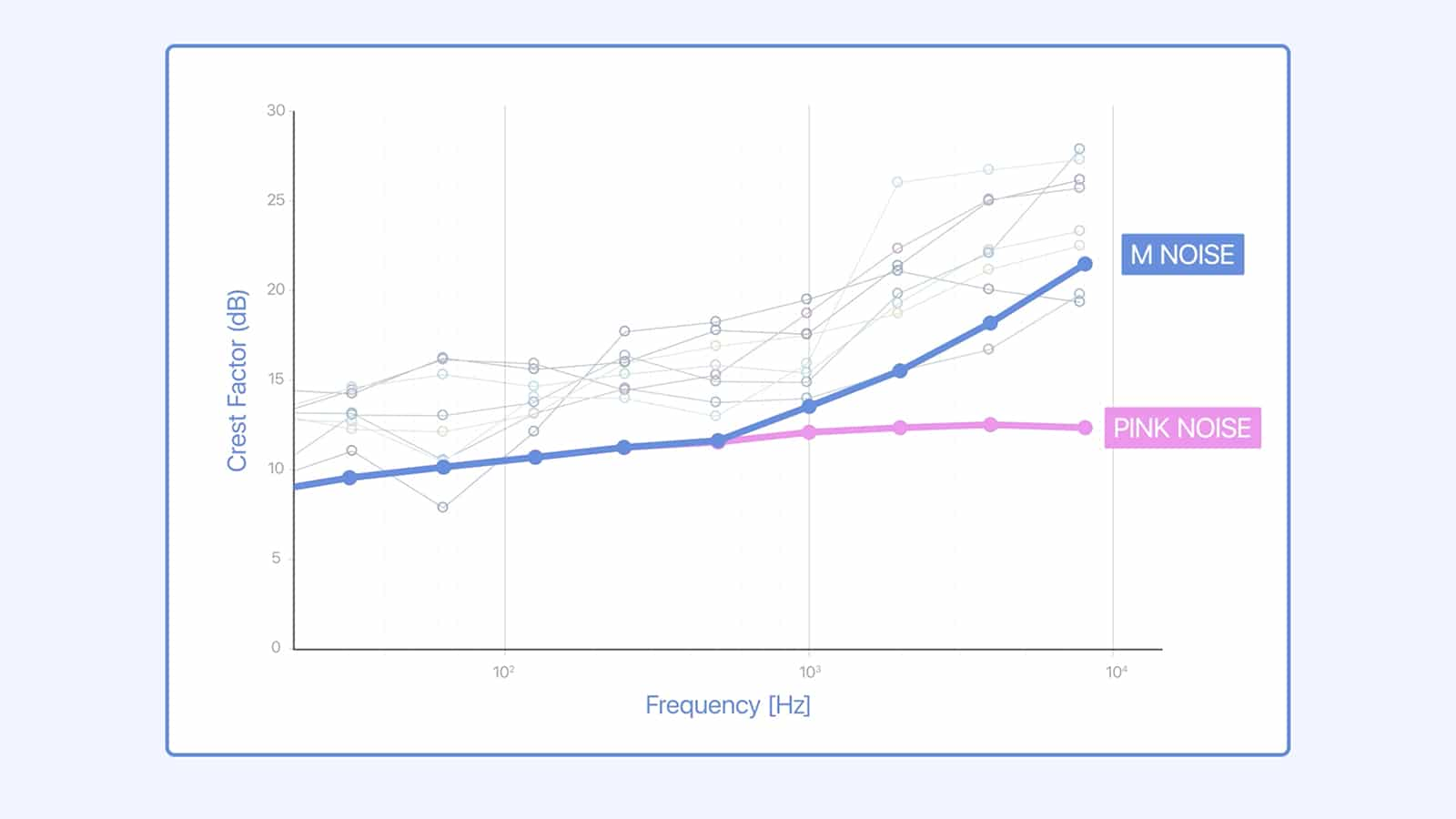

In my opinion, a nice 50W amplifier with good noise and distortion performance in the 1-10W range is sufficient for indoor PA applications. However, this ballpark is only for the HF compression driver (woofer not included).
Considering that the LF/HF half-way power split is at about 300-350Hz crossover, the max HF power for PA should still be less than 100W for a decently sensitive compression driver.
I mentioned linear amps only because of the power levels involved. Class D would work as well. Also, it may not be necessary to spend a lot of money on shiny finished products with features such as remote control, blue-tooth, wireless etc., as PA is mostly installed sound.
If you want a high M-noise score you need a large amp on the compression driver to cope with the crest factor at high frequencies:
20dB of crest factor is 100x the average power so if your average power is 10W you need a 1kW amp on the compression driver. If you look at Meyer sounds own speakers they incorporate what look to be amplifier modules from Pascall (from panther webpage):
they seem to be using large stereo amplifiers with one operating in bridge mode for the bass drivers and two seperate channels for the two compresion drivers (presumably for variable control of the two drivers in arrray usage). Whether compresion of the high frequencies is important or not is debatable but there seems to be argument for using larger amplifiers than are typicaly thought to be required if you want to avoid clipping.
