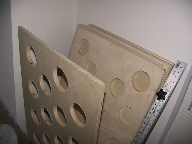

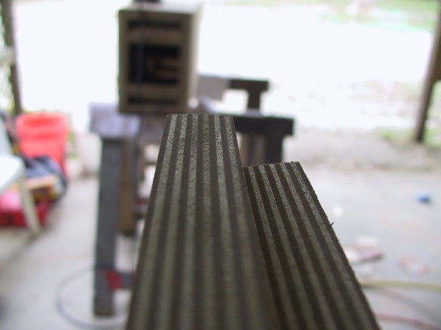

I like to buy the 2'x4' sheets of mdf and 13 layer birch plywood from home depot. I haven't had any problems using them, and I haven't had any speaker designs that require larger pieces. They also fit in my car rather well. The prices aren't much more compared to the full sheets.
Another advantage with buying 4 - 2'x4' sheets instead of 1 - 4'x8' sheet is that the 2'x4' have perfect edges to reference when cutting your pieces.
2'x4' mdf sheets are around $5 each at home depot and the plywood ones are around $14 each. They certainly make life easier.
